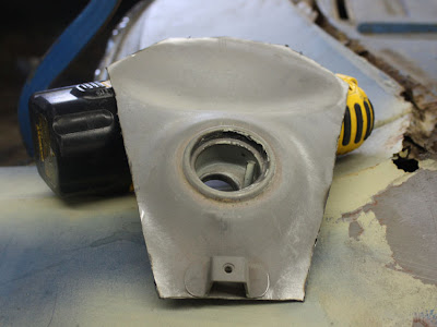

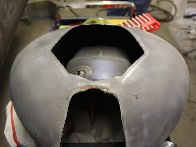

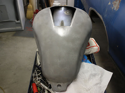

Spent much of the day in my buddy's shop, finally cutting on my new gas tank. I cut out the top, cleaned up and flanged the edge, made a template, and my buddy metalworked the sheetmetal patch. Unfortunately he was out of welding gas so it didn't get finished today. But it's gonna be the awesomest tank ever.
Album with larger pictures (and a bonus surprise).
I really gotta get a new camera. I took these with my buddy's digital SLR. What an amazing camera.

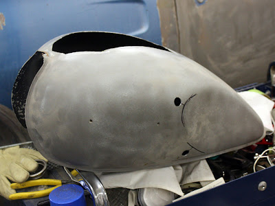

Whats with the holes in side? Going to install a sight guage?

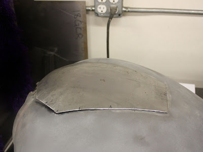

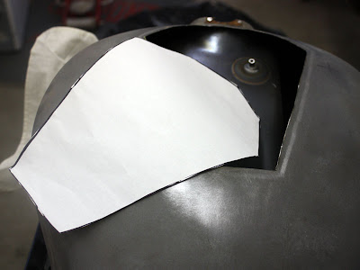

Is the patch hammered or rolled?
Nothing gets by you old man.
A little bit of both. He has a roller-brake-shear combo unit. He rolled a crown north-south, then used a shrinker to get the sides to curl down, then when that started to make too much of a ridge around the sides, he massaged it with hammer and dolly. All the while he was whining about how he wished he had an english wheel. He's going to tack the back first and hammer weld the final shape as he tacks it down before finish-welding it all around, alternating spots naturally so as to not warp it. Then a new gas filler bung and a little bit of mud the top will be ready for paint. We will be resealing the inside of the tank. To give you some (two) hints on the gas filler...

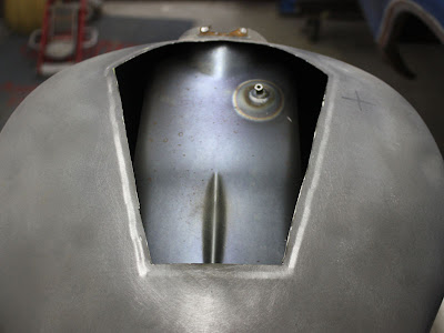

Hey, does anyone know if I'm getting myself in trouble by eliminating the vent tube from the tunnel to the filler bung? My new filler cap is vented. Planning on welding the tube shut. I know it was discussed previously, just too late and too tired to search for it right now.
P.S. Also filling the emblem holes on the sides of the tank.

I've ripped out the vent line from the tank and plugged the nipple. No problems if you have a vented gas cap. Makes it so much easier when taking off and putting on the tank.

I plugged the hole as well when I put on a vented cap. No problems, and yes, tank removal is a breeze.
I remember you talking about a fuel sight gauge a long time ago, that will look awesome!

Btw... was it full of gas vapour before you started? If so, how did you eliminate all them fumes?
I picked this tank up 2-3 years ago. It's had plenty of time to vent and dry out.

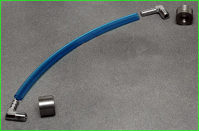

I've seen sight gauges on a number of old school, rat, and retro choppers and just thought it would be cool because I'm going for a sort of retro inspired (but not authentic) look.
There are a number of "kits" out there, but they all require welding. I didn't like the bungs in some of the kits so I bought this one (came with a clear tube, though):
We're going to weld them in so they stick out about 1/16-1/8" from the tank.

That tank's gonna look awesome when it's finished FriarJohn. If that sight tube is 1/4" i.d. & 3/8" o.d., Lowbrow customs has colored fuel line in several colors. There's also this place:
http://www.oemcycle.com/Item/product/6547

Those are great sources. I was thinking more along these lines (see what I did there?)...
http://www.motionpro.com/motorcycle/partno/12-0059/
I just don't know if the nylon braiding would obscure the view of the gas too much.

FWIW...Id suggest clear or a color to offset the paint. The braiding may take too much attention as a "sore thumb" effect vs. a "cool but functional feature".
Oh...and while your at it...might be cool to use the same tubing all the way through the fuel feed to the carbs. A sort of "bring it together" thing.

I think the braided line looks less retro but more "racery." Yes, I just made that word up.
I'll probably just use the clear line that came with the kit, at least initially.

That braided line just don't look right IMHO. Just not 'authentic' enough? Go clear so it looks more like glass.
