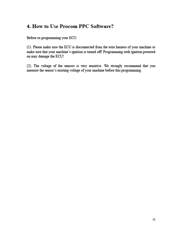

Re: New CDI for Triumphs HELP
Gregger #368863 01/11/2010 3:01 PM
Missing pages are either how to install or how to use. Me? I'll be using the default map. I can say regarding this verbage: "In addition, you can select a map from our CD kit or free download more maps from our web site: www.procomeng.com." I have no maps on the CD Kit nor have I gone to www.procomeng.com.

Thank Moe for the PDF. I tried to post mine but couldn't.
Ok, once again here is the question. Which ignitor do you use for the 270 engines below 237500 and for the ones above 237501 for the America? Maybe I'm getting my > < signs mixed up????
