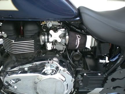

I decided it was time to do what a lot of other members have done, and replace my factory airbox with some K&N filters. It was a pain but I got everything put back together and took her for a test ride. The bike's running great, but I do have one minor concern. It seems like the carbs will randomly "sneeze", mostly when the bike's idling. It doesn't seem to effect performance or anything else, but I'd like to make it stop doing that if possible. They kind of pop and try to pull out of the rubber mounts. Fortunately, my carb brace keeps them in place when this happens, but it still seems a little off putting. Anyone have any ideas for me? Besides the filters, I went from 132/45 jets to 145/42 jets as I could smell gas when I was idling with the 45s in and got sick of people commenting on it. I also adjusted my air mix screw to 2 turns out from 3 turns out. I figure it's just a fine tuning thing and I've never had this problem before but thought I'd reach out and see if any of you had suggestions as to where I should start tinkering.

Thanks for all the great suggestions everyone. I adjusted the mixture screws as suggested and now the bike's running better than ever! It's sunny here in Seattle so I went for a long ride just now and didn't have a single hiccup so I'm feeling pretty relieved. I actually am planning on using my friend's vacuum gauges to sync the carbs, I just wanted to get it running right before going any distance. I am also aware that 145s are probably too lean. I also have a pair of 150s and a pair 160s which is what Pat's jetting calculator recommended, but that seems pretty big and I didn't want to be running rich after having that problem with the 45 pilots. Thought I'd work my way up. I also have some shims but haven't played around with those yet. I took the advice of switching the bowl screws to allen style, so swapping jets shouldn't be a problem. I had to take off the back tire to get the airbox out intact, and decided to upgrade to a 19 tooth sprocket while I had the chain off. Basically changed a lot of little stuff I was too busy riding to bother with when the weather was warm.
I bought a battery bracket from brokenfixed, and relocated the battery to under the seat. Using his prefab bracket saved me a lot of time on this project. It worked awesome, but I made a slight modification as far as the key position. I also removed that hidden fuel filter and put on a clear inline one instead, and upgraded the all the hose clamps while I was at it. I hope to have her in good shape for some long rides this spring. Thanks for everyone who gave me advice along the way.
Re: Carb Help
Captain_Midnight #367411 12/27/2009 7:00 PM

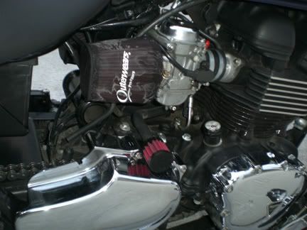

Wow...sounds like you've gotten a lot of work in lately. I'm glad it sounds like you've got your carb issues under control now. The bike looks great with the bat relocation. What is the x shaped object over the carb in the second pic?

Choke lever knob. Someone on here made on from an old sink handle. I found one laying around a friend's house, gutted it, JB Welded a screw into it, and put it on. It works great when the weather's cold and I've got gloves on. I think it started off as a joke. It's been suggested that I should take it to the next level by hanging a pair of those metal tea balls off the bottom of the bike.
