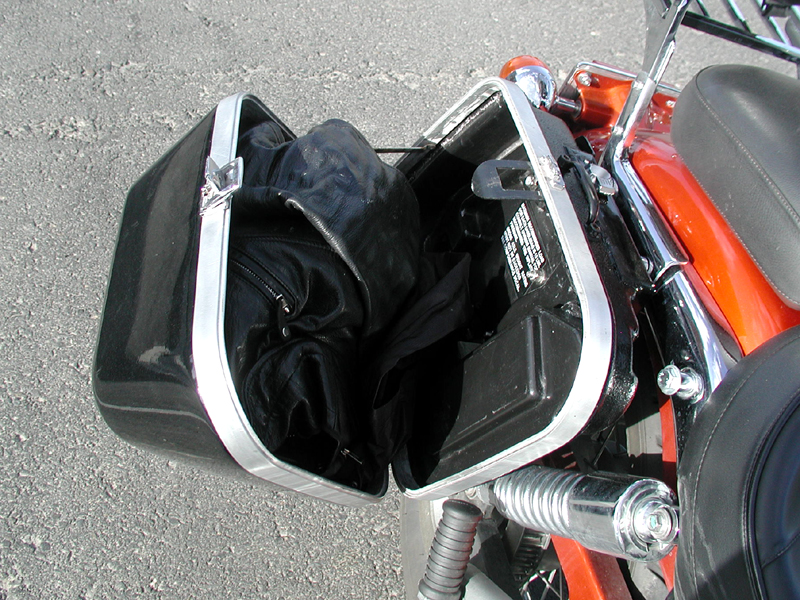

Bags are fitted on the bike. They look great as you can see below :
Rear view :
I did not mount them myself , my vendor did it.
I have to say you that it was very hard to fit because mounting brackets were not well manufactured (sic) even if they still look great and I'm sure steel is a good one. But It seems that holes were not really at the right place , so he spend more than 4 hours to fit them.
I've another request :
I think the brackets are not sufficient because they just maintain the bag from the top. there is nothing below to carry them. In the next days, I'll ask another vendor to make another steel bracket that fit in place of the rear footpeg, pass below the bag, then up to the fender. This way, the bag will be fixed on the fender (should probably be consolidated), so it will not (or less) vibrate when riding, and I 'll be able to fill the bag with more weight.
I have to relocate rear footpegs because they are not usable easily now but that should be not so hard to do.
(I try to translate for you ... )
Another thing : I asked him to plug the light with the rear beam because it was not necessary to remove the turn signal and this way, the bike will be more visible from rear (3 light sources rather than one). So he has painted the light window in red because in France rear beam must be red.
I ordered at newspeedmaster. That would be great to order optional parts like red embeded turn signal (they came Amber) and bag guards. I think I've to order those at Tsukayu web site.
Anyway, I love these bags. They look great and will be usefull for sure.

Hi guys !
here are some improvements I ask to a friend of mine (HD specialist).
First I ask him to make a patch to reinforce Tsukayu's brackets.
It's 5mm aluminium.
Then I ask him to make another bracket that fit into the fender and comes at the bottom of the bag :
Center part (A) is fitted inside the fender , under the rear beam. Parts B and C are fitted at the bottom of the bags.
Both parts are connected to part A. This way, I can disassemble the bag in order to make some maintenance with the rear wheel
By now, it's black painted. I've to ride some KM, maybe to make adjustments. Then they will be powder coated.
Finally, bags are really reinforced. No more vibes. When you push one bag, you can feel that both bags and rear fender seems to make only one piece. Now , I can fill them in , I'm sure the weight will not be a problem anymore.
I'll take more closer shots soon...
Complete story is here (in french) :
http://www.triumph-america.com/article/M/20/renforts-pour-sacoches-rigides-tsukayu-strong-bags
That cost me a lot but I knew the rules and I'm happy now.

Here are other pictures I took today :
Rear view. Here we can see the parts B and C
A view of the fender and the C part.
The aluminium patch between the bracket and the bag
View from the bottom of the bag
Here is the entiere B part viewed from bottom
