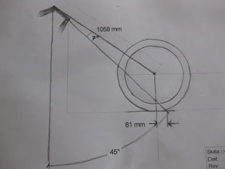

I have made a blue-print in order to get started with my project of reaking my beloved America. I am however a bit uncertan about the tripple trees. All I did here was adding another 7 degrees to the 45 degrees I plan to reak the neck to. If you see anything bad with this blue-print... Please let me know, that will probably save me from a lot of work. The reaking angles are the same as "Wasntme"´s bike. But I dont know if we have the same trail.

One problem I see with it is THAT ITS IN MILLIMETERS!!!
haha...God bless America

hahahaa, yea. A small measure of lenght for a grand plan!
The average description of forks was killing me for a while there. "+10"...of what !!! ?

I happened to see the steering head bearings for the bonneville/america the other day. They seemed smallish and I'm not sure I would subject them to any more rake stress than they've already got - you might want to see if there's a way to beef them up.
Some of the members here have replaced the stock ball bearings with tapered rollers, looks to be the trick setup.
