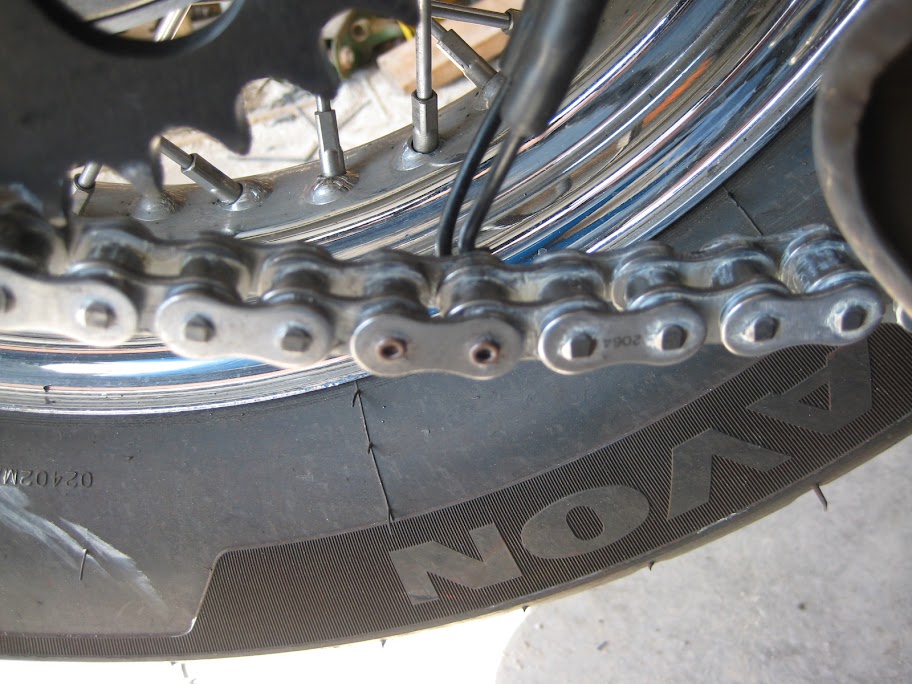

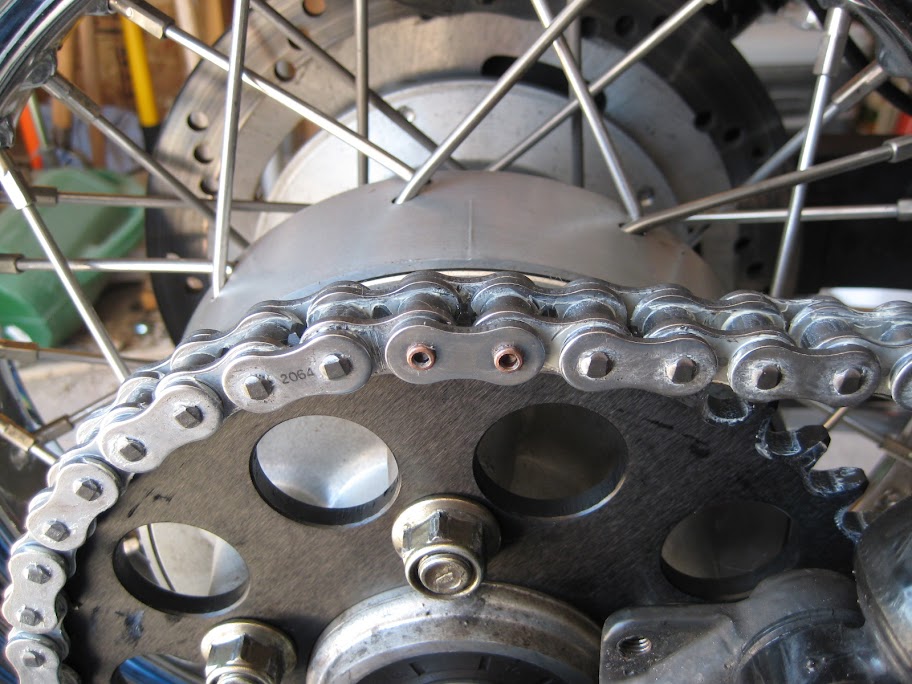

Okay, I'm almost done. I just compressed the rivet link and I'm wondering how I tell if it's compressed enough. How hard do I reef on the rivet tool? I took some pictures here, but here are the two applicable photos (ignore the Scottoiler tubes):

It looks good. You don't want the chain to bind or flatten out the o-rings too much. Give it a quick messure and if your within a couple of thousands of the original links you should be there.

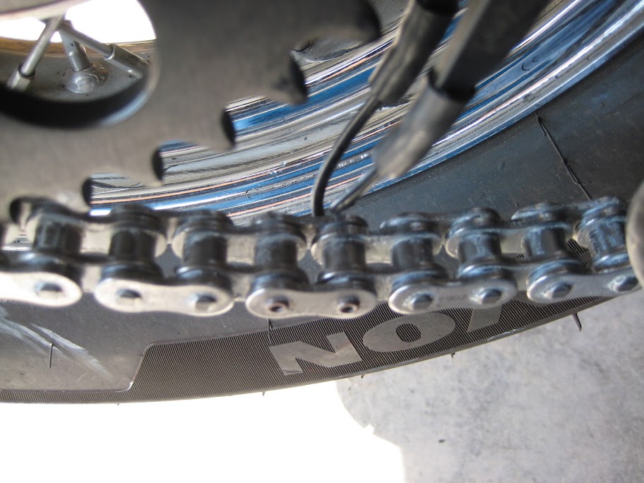

Update: after calling FastEddy and re-reading the instructions, I found out that I need to use the flare head and flare the ends out. Here's what that looks like, assuming I did it enough:
