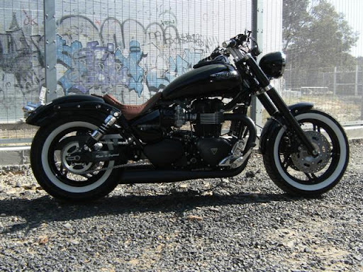

Richard, try putting a 17mm ball bearing in the hose that runs from your airbox up to the AI. This is effectively the same as removing it but leaves all the hardware insitu.
See if that reduces the popping.
Are you running the tune from my bike?
The one on his website for speedmaster, pod filters+custom exhaust+02 sensors disabled?

I have had my whole system ceramic coated, Definately NO cats.
I have done 6000k's since my mods and the remapping, everything is perfect.

My pipes were statring to blue, even with the AI removed, I didn't mind the look of it but the black ceramic fitted my bikes theme a touch better.
My understanding is AI produces more heat. So even if you had cats or pre cats I don't see how they would suffer from less heat, it may effect how quickley they reach operating temprature? Not sure , I personally am a dog person and don't see the need for cats on anything
