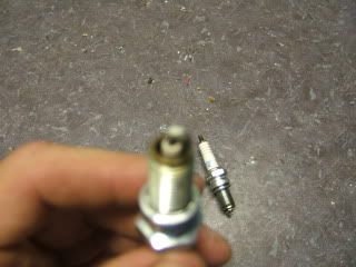

[image][/image] i went out for about an hour yesterday. the plug base has a copper color to it and the ground straps have a little white tip to them. the bike seems to run great. I've noticed more power since I took out the stock air box and added the pods. I had the air mixture screws at 2 1/8 and turned them in to 1 1/2 out. When I let off the throttle it "crackles and pops" as i'm slowing down. I really like the sound and it made this sound with the stock air box. I think everything is running as it should.

well Im no expert and that plug is out of focus but... I would hazzard a guess and say its too lean, 2 1/2 turns out would seem better..
Like I say... Im no expert and make from this what you want

Ya, the quality kinda sucks. I took about 10 pics and that was the best. ya, i might take them off and turn that screw out a bit. thanks
