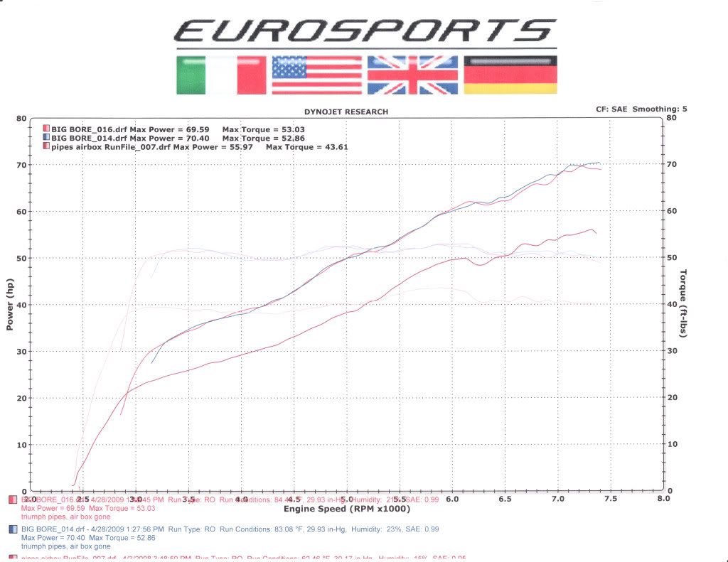

I just had a dyno-tune performed on my "new" bike after the break-in period following a 904 BB (it was a 790cc). This was at a Triumph dealer. I asked the service manager if this included balancing the carbs and she said "of course". After it was all said and done (the guy doing the runs seemed to know his stuff, and spent a long time analyzing and tweaking with the sniffer in each exhaust) I ended up with:
Left Carb:
- 155 Main, 42 pilot, 2 shims
Right Carb:
- 150 Main, 42 pilot, 1 shim
In the notes he remarked that airflow was different from left to right.
I had a chance to talk to him and asked about this difference and remarked that I thought that the carb balance screw would remedy this. He said not really and showed me the different charts he ran and this and that. I was short on time so I didn't get into it, plus I knew he was consulting the the other mechanic who I know is Triumph and Ducati factory trained and works on race bikes and such while he was making these decisions.
Has anyone else heard of this? I don't remember reading where anyone else had different jets on their carbs.
BTW, my bike is running awesome. I went from 56 hp and 43 ft/lbs torque running long TORS and airbox eliminated pre-big-bore, to 70 hp and 53 ft/lbs torque with Specialty Spare Long slash-cuts.
Here's my dyno-run chart showing the old run and new ones:
[image]http://i89.photobucket.com/albums/k214/airbuspete/TBA/dynorun.jpg[/image]

Interesting post. Did you have any head work done that may have caused an airflow imbalance?
Re: Different jetting between the carbs
mrt202 #329003 04/29/2009 9:28 PM
Posts: 149
Pete777 Offline OP
Posts: 149
Hmm, I hadn't thought about that, but yes, I did. While the barrels were out getting bored I asked if they could "clean up" the head. They spent about 3 shop hours (I sometimes wonder what that translates to in real hours) porting and polishing (probably not a true port and polish, more of a clean up). They said it would yield a bit more bottom end torque. I hope that's not what is causing the imbalance! The bike runs great, I just hope it stays that way!
'05 America, 904, K&N pods, British Customs Bomber Exhaust
Pete777 #329004 04/29/2009 9:52 PM
Posts: 1,668
Posts: 1,668
I'm betting the intakes are hogged out unequally. That's what they make flow benches for. I wonder what the mis-match is gonna cost you performance-wise?

I presume that Bill H. ran the dyno. My 865 did 52 lbs of torque (uncorrected)on that same dyno, on a cooler day.

You obviously know the dealership. Actually it was Glen(young guy)who did everything, the BB, headwork, dynos. I was kind of bummed when I found out that is wasn't Bill, but Glen seems like a good guy and I hope Bill was kind of watching over his shoulder. Since I was there waiting while they ran the dynos I did see Bill looking at the charts in between runs, so I think he had an input to the proper jetting and tuning decisions. Hopefully it wasn't, "geez Glen, you #@%&'ed up that headwork, now how are we going to fix it?!" If I hadn't asked, I don't think they would have even told me what the final jetting was.
That's a great torque number for you Ken. I'm happy with my gains though, 20% in both hp and tq.

My bad, the max. torque on my Feb 09 run (865, stock internals) was 51.10 uncorrected...
That's OK Ken, what's .9 ft/lbs amongst friends!
