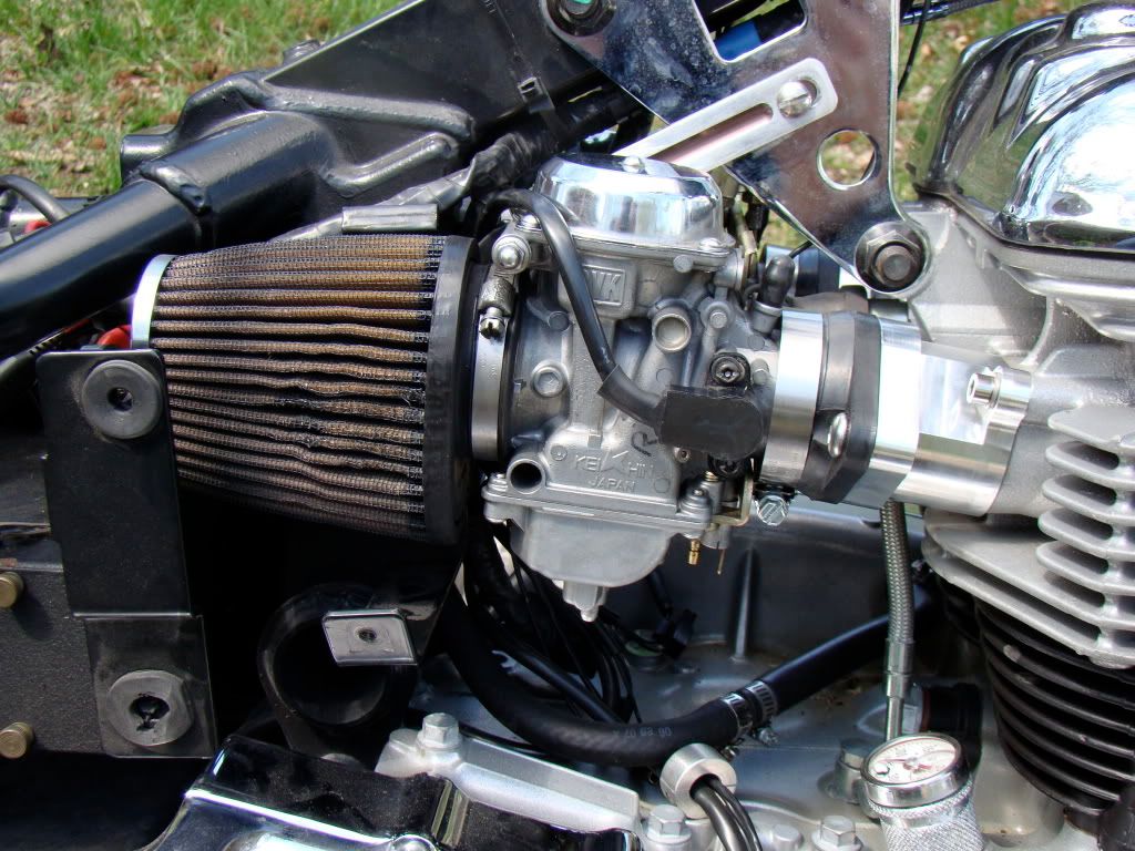

Here it is installed, you can see the air filter and how the left side will hit the frame. Also, the cheese grater doesn't fit back over the filter

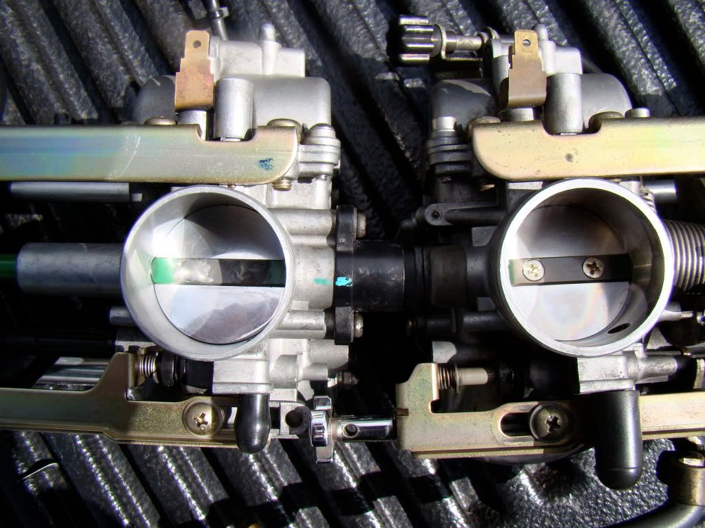

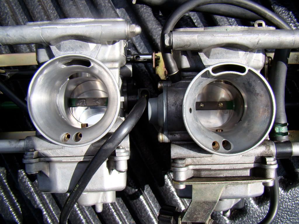

Side by side pics
and down the manifold into the head
Man that beat up K & N looks familiar

Yeah, I felt like an idiot the first time I struggled to get it on for like 5 minutes only to realize it was for the other side! And I need to clean it, too.

Hey thanks for the info and pic's
Question about swirling?
What part of the carb is it done on and is it a heavy cut or like a 100 grit sanding?
Thanks!

It's not that heavy, and the intake manifolds really seem to have it more pronounced than the carbs. Maybe it's the way the manifolds are cnc cut that gets it like that. If you look at the side by side pic, you can get a good idea of how much is bored out, look at the difference of where the needle goes down into the collar. That's the smallest place that can be bored out, and it's still a good amount of difference. We're only talking about millimeters here, but the flow numbers are much improved.

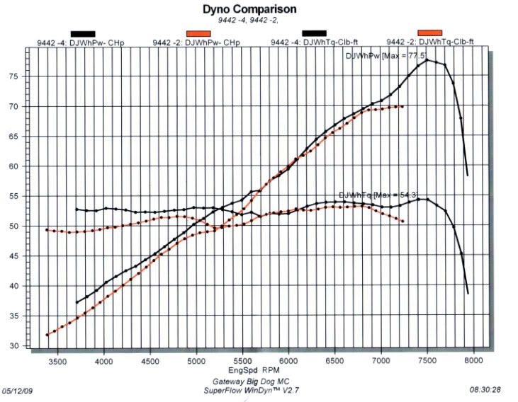

8HP!!
roadworthy #326597 05/12/2009 11:42 AM
Posts: 10,721
Posts: 10,721
Red lines are my first big bore run, black are with the new bored out carbs
8 more hp! Manifolds are still to come, and I still need to get it tuned in just right for air/fuel.
