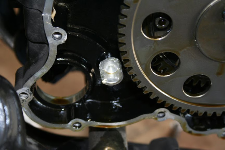

This may not be the right forum but I didn't know where else to post this. I Took my 2005 Speedmaster to the local dealer to find out why it wouldn't start. They are telling me that my crankcase is cracked in a place that holds a pin in place that holds the idler gear in place. I am now looking at over $3000 in repairs on a bike that has 2500 miles. My options are to fix it for $3000, sell it back to the dealer I bought it from let them fix it and sell it or have a nice decoration for my garage. Any suggestions?

I'm sure most of the fellows who have had this problem were covered under warranty, even those whose warranty was over. The broken starter idler gear bushing is a known issue with the starter circuit which is usually due to backfiring on startup (my opinion though). If the dealer won't help you, contact Triumph direct and state your case. It can't hurt and only help. 2500 miles is peanuts.
I'm sure some of the guys will pipe up concerning what they went through with this problem.

It did happen to mine not long after installing the BB but it's just coincidental. Triumph made a design change in about 07 to correct the problem. The inside socket (part of the engine casing) for the idler gear shaft was weak. The newer engine casings have a beefed up socket.
My bike was off warranty almost 8 months, but my dealer was able to get Triumph to cover it. It took a long time (over a month) to get a new casing from England. My bike was in the shop almost two months. The starter broke just as I was picking it up from a follow up service check after a 1000 miles on the BB.
I guess I was lucky. Triumph claims there is only a 2% failure rate, but have done a lot of replacements out of warranty. Get your dealer to help.

You wonder if they shouldn't press a steel bushing over each idler gear boss to keep the aluminum from separating. If the bike backfires hard enough on startup, it could happen to any bike.
Does anyone have a picture of the updated case/cover? Is there much difference?

The broken crankcase at the starter idle gear; happened/happens to the bikes build from 02-05, early 790 motors with the old style crankcase breather. They redesigned the crankcase breather and bridged the block in that particular area in the second part of 2005. So in 05 there are bikes with the earlier crankcase breather style and the newer/current style. Having said that, my Bonnie is an 03,the same situation happened to me when I was out of warranty back in January 06 and Triumph covered the expenses. Carburetors backfiring was the cause of my crankcase failure.

Mine happened at 12000 miles in March '08. Because Triumph was giving some race support to my dealer (D&D Cycles, Pensacola), the owner/service manager showed me a number of engines Triumph had sent them with the same exact break. They didn't need the starters - take them out anyway.
Don't know about adding weld support. It's always the top part of the socket that breaks off - when the starter torques.

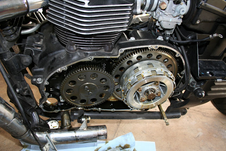

My buddy has an 06 speedmaster and the whole case is beefier than on my 04. It seems they added where the breather hose comes out of the case. If I am looking at the right lace it is very esy to spot. 04 slopes off fast where the 06 has a bulge by the breather hose.

If you look at the top of the primary there is a large casting that goes back under the carbs on top of the tranny. That is the new style breather.

Dog33...the large casting on top of the primary that you are referring to: is that the square casting? If not, I'm not sure I can locate it. Can you post a picture pointing this out? You will be relieving some folks, and warning others. thanks
