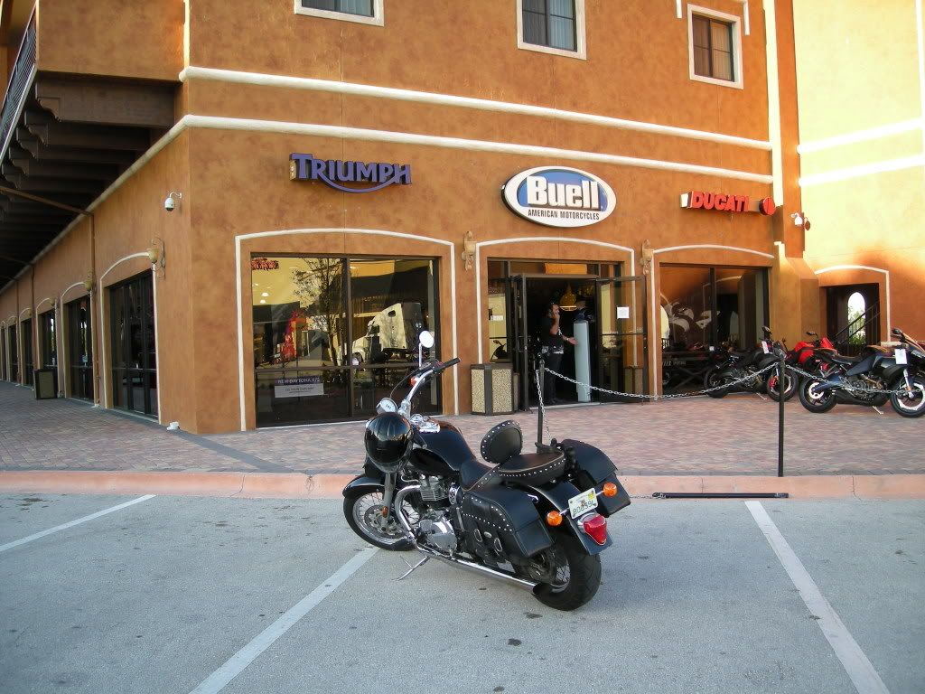

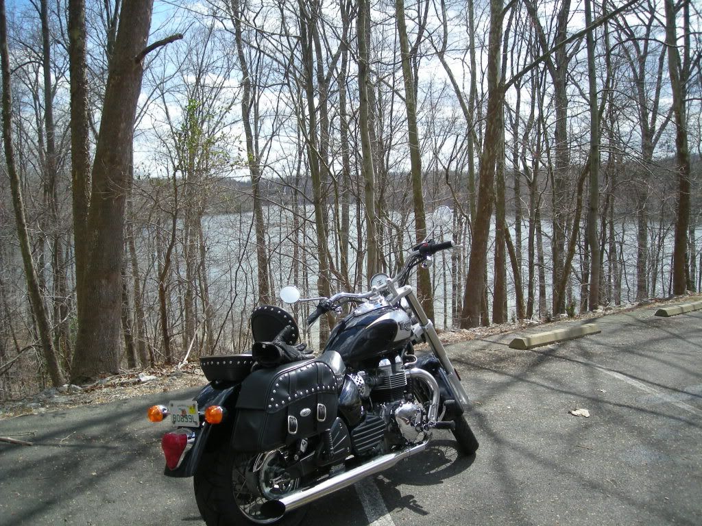

Rolled 1800 miles and here is how Vera Lynn looked at departure:
Fountainhead Regional Park, VA
and 60 miles from home on my return.
