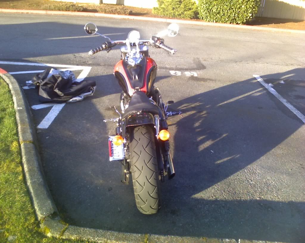

I am intrested in running only the iso grip end LED's on the front. I've bobbed my rear fender, relocated the number plate, and am looking to clean up the lines of bike. I would like to add a pic or two but I dont have a web page or photobucket account.

Here you go...

You could build the signals into the corners of the underside of that frear fender, kinda hid em....or a strip of leds that act as turn indicators...similar to the Vrod (I think).

You can see the blinkers on the end of the bars from behind can't you? I was thinking of buying those for just that reason and getting rid of my rear blinkers as well.

Yes you see the end grips from the rear But as is stated in the next post if your hand goes towards the end in the day time it is a little difficult to see( I mostly use arm signals anyway).

I did not recieve any instructions with my kit or screws either I had to call New Bonneville to get the screws . Their are three wire RED,WHITE,BLACK. Red is for the turn signal, white for the running light, and the black one is the ground. I am currently running the rears to complete the circuit so they will blink.Are currebtly running the front only or both?

In regards to your rear turn signals...
I see you mounted them on the fender strut...
would you happen to know the bolt size?
I'm looking at lights that require 8mm. wanna make sure it'll work...
Thanks.
Re: Front turn signals only?
dgart08 #325375 04/17/2009 5:10 PM
Joined: Sep 2008
Posts: 54
Joined: Sep 2008
Posts: 54
Yes I believe it is a 8mm bolt from where the signals were mounted on the front.Those turn signals and bolts were reused from the front and relocated to the rear.
