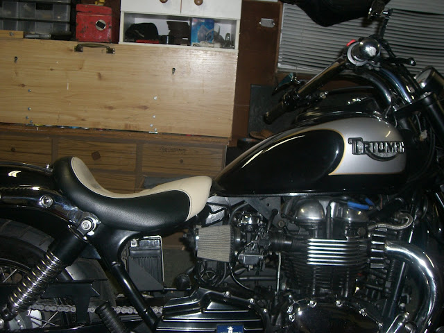

+1 on the carving knife! I took to my stock seat witha carving knife and dished out the back of the seat the same as Paula is saying. I smoothed my seat using an angle grinder with a sanding disk on it. Because I'm such a cheap ****** I put the original cover back on and pulled down tight into the dish with some buttons tied through the back of the seat pan.this worked pretty good as it was really comfortable, the upholstery just look a little bit chatty,but served me well for quite some time. The two tone seat in the centre of the photo is the second incarnation of that same original stock seat. This time around I narrowed the seat pan and trimmed the foam to suit. I was so pleased with how it turned out that I decided to part with some of my hard earned and actually took it to a young upholstery dude.

Wow Brent! VERY nice job on that B&W seat there, guy!!! I also cut down the side on my stock seat to make a very similar look to that one. However, instead of cutting the down, I actually added about an inch and a half of foam along the top in order to flatten it out some. Now, you may be wondering why I did that...well, it's really very simple. It's 'cause a dished out seat locks you in one position on said seat, often causing "hot spots" on the ol' rump. And so, NOW I can move around on that seat o' mine juuuuuust fine, and can sit on that puppy for hours on end without ever gettin' those "hot spots". But yeah, every butt is different I suppose, right?!
And BTW, I see you have also made some finned exhaust header clamps that mimic the ol' Triumphs clamps, just like I did a year years ago.
I found a set on those old large-pronged units you used to see on those old Triumph choppers back in the day, and I grounded off those prongs and rounded 'em to look like the old stock units.
How did you make yours?

Dwight, yes mate, as far as seats go its each to their own. Although I have never personally seen one, I based the rejig of My seat on photographs I have seen of Corbin seats. I much prefer to be planted in the seat then be sitting up on top of it. I have put in quite a few big kilometre days and have never had a sore aarse. Dude, believe me this is one really comfortable seat. I bought the exhaust fin clamps on eBay. I welded an aluminium block opposite the clamping point on each of the clamps and then split them in half. I drilled and tapped the aluminium block that I welded. I had to remove the shield at the top of the header pipes. This allowed the split clamp to fit around the header pipe and fasten up with the two clamping bolts. I hope that's clear enough for you. I think they look pretty good and I've had heaps of positive comments about them.

I want one of those cut down stock seats! Dad gum that thing looks SWEET!
