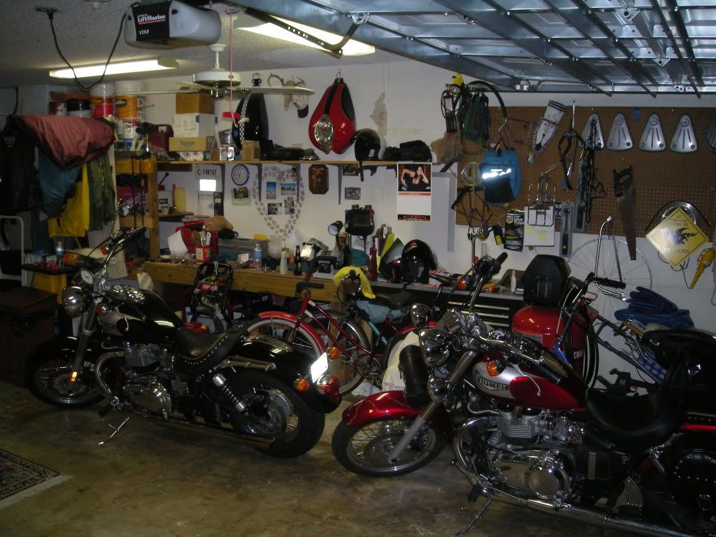

Let's hope it is fuel related. Try pulling the choke out when the bike coughs and sputters. if it smooths out then pull the carbs and clean properly. Sounds like space is an issue for you. here's my garage with the highlander backed out. I have a lot of stuff to move to work on anything too! When the wife's suv is parked you have to turn sideways to walk up by it. The jack is under the wheel hanging on the board with hedge trimmers stacked on top next to the lawnmower which is laden with seat cushions for outside chairs. To get to those i have to move two or three bicycles. Heck in this pic i even have my tent hanging on the clothes line in order to dry out from the Arkansas Rally. dangit. Speaking of the tent, just to the left of the tent (out of frame) is thee most important item in any garage: the beer fridge! At least the calendar has a clear view on what is important! Just trying to lighten up your mood is all. You'll tackle this. be methodical and sort through it.

Oh, and moe, see that space in between all your bikes? That's all the space I have to work in. Your garage (pronounced "Gah-ridge") is HYOOGE compared to what we have over here.
