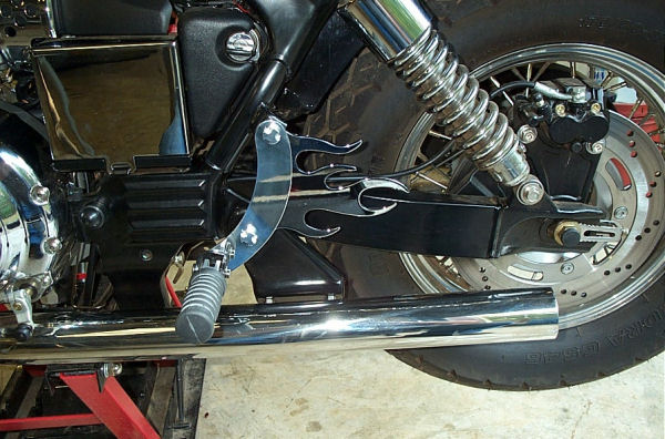

Hey Gang - Pop and I came up with an idea to allow for the removal of the stock peg finishers but retain the ability to have a passenger if needed. It's a 1/2" thick piece of stainless that will be mounted in front of the Solo Finisher that extends low enough to accept the stock rear peg. The benefits would be that you can convert your bike from solo to pillion abled in 5 minutes. It'd also give the passenger a MUCH more comfortable ride allowing them to stretch out a bit.
This is the first prototype so keep in mind that the peg bar would be polished to a mirror finish, or chrome plated.
Please let me know your thoughts on this, pro or con....
BTW - see Pop's new Hammerhead peg bolts? :-)

When you say 1/2" thick, is that the actual thickness or the width. I'm guessing width. Looks like a viable option for those who have the need.

I like it, it blends well. How about turning the pegs so they lay parallel with the pipes/swingarm? You don't lose any functionality and I think they would look better folded back instead of up (I may be prejudiced, that's the way I have mine now!).
1/2" SS? Man, you ain't messing around!!
I am guessing when you say solo to passenger you mean the seat? The pegs would stay?
btw, I have the pegs in the lower hole (pipe hanger one) and Janet likes it much better as she can stretch her legs more.
I friggin LOVE those bolts!! I NEED two!! Talk to me!!
Not sure about the tribal finisher. I kinda like it but I don't know if I like it with the peg lowering piece. Do you have any pics with just the finisher?
No. The thickness of the material will be either 3/8" or 1/2". If a big person puts their full weight on one side, we want to make ****** sure it's safe.
The way we envisioned it, if you want to ride solo, you can remove the peg bar leaving the Solo Finisher. It's up to you whether or not to remove the seat.
Good idear. Thanks!

So if they are 1/2" thick, you need longer bolts to install them, correct?
Oh yeah. Chrome bolts would be included in the kit.

Good idea... if I was doing the solo thing I'd grab it. If you make the pegs lie flat they won't be too obvious, which'd mean you could just pull off the pillion for the solo look. Loved the hammerhead bolts - will they fit on the standard rear peg hangers? Probably not a lot of point with the recesses in the OEM hangers I guess.
Know what I'd REALLY like to see you do tho? Find a reasonably priced source for those replica HD softtail toolboxes and fabricate brackets to mount them and rear pegs, and sell the lot as a kit. I know they come in black as well - perhaps the speedmaster crew'd be interested in them.

Looks like a nice, simple way of relocating the pegs. Couldn't you even put the peg plate BEHIND the solo finisher? Hike it more? Also, word of caition on laying the pegs flat, they will like to fold back a lot easier if your passenger has squirmy feet.

I like the idea Brent. Is is possible to put the bracket behind the finisher? I'm thinking that set up would bring out the look of the finisher better and hide the bracket as well.

Would you offer an integrated unit, i.e. a non-convertible model? Sort of like leaving material on your 'Holes Solo Finishers' so the peg could be mounted to it in the same relative position as your prototype? Those that generally ride solo, never know when they may get lucky! Can you hear me across the pond in Northampshire?
Thus a second reason for a non-convertible model.
Sure. That's certainly an option.
That was our first thought but the convertible option would be much cheaper. An entire finisher made of 1/2" stainless would get pretty pricey.

Nice one, Brent. Would it work if the bracket was mounted behind the flame finisher? If it does, I'm in. Now I gotta raid my kids' piggy bank!

For the peg angle, you could mill in a recess and include washerlike inserts with holes to match the peg locating pins. That way, the buyer could angle the pegs however he wants.
