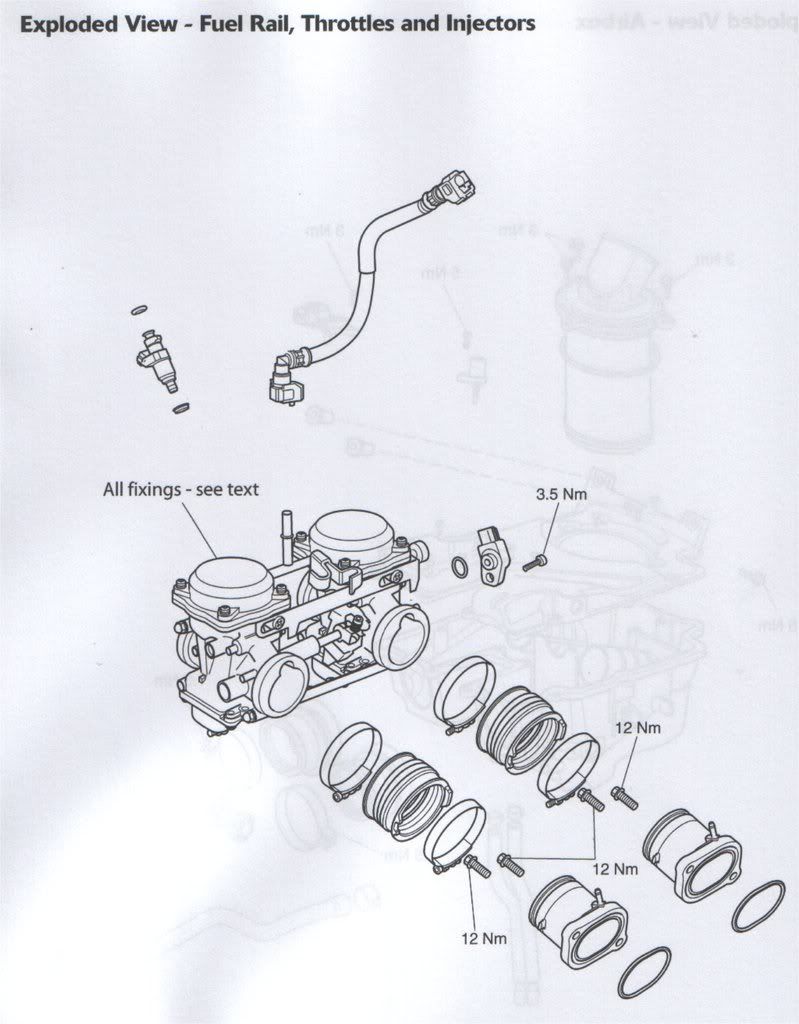

I posted it up a while back on how to remove the tank from an EFI...
    1. Seats need to be took off
    2. Remove bolt from rear of tank
    3. Remove centre console
    4. You need to lift tank up, (while someone else undoes the fuel pipe and electrics
    5. The fuel pipe has a plastic cover which slides to one side, you then need to squeeze the connection together to release it.
    6. Undo petrol pipe from underneath the tank not from the carbs, also have a rag covering the engine side..
Pic showing fuel pipe, but do not forget about the 12v power lead
Any other info you require from the shop manual for an EFI..
