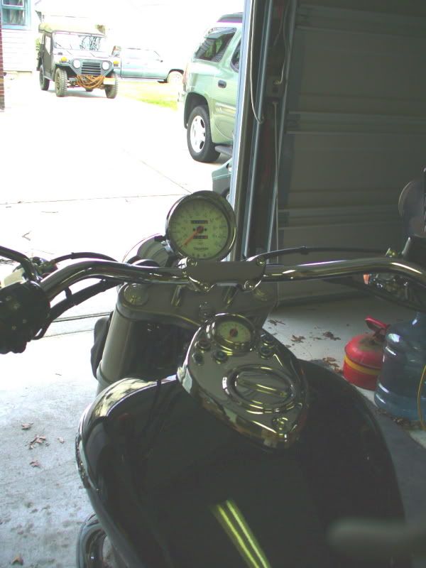

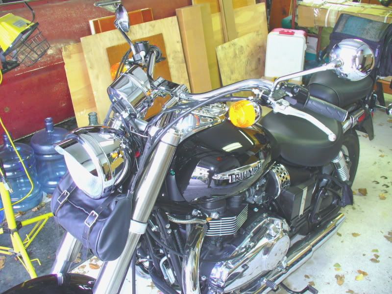

Third try... New Risers

not sure what pic you want.
Same risers I have, like em?

Thanks for the help Ian. I'm going for a ride later today, but they seem to make the seating angle better and relax your arms. High quality parts, everything fit, the stock BA cables and wires were ok (thanks birchr for the tip on extra wire in the headlight). I did loctite the 1/2-13 studs into the riserbody and reused that trick locknut on the 10 mm side torqued to 50 ft/lbs. The whole magilla only took about two hours in 38 degree sunshine. I like how they blend in so smoothly with the headstock, not so 'clampy' like the originals were.
PMing you Ian on the photo tech.
Howzat, Clay? Pix galore.
Re: OK, I pulled the trigger on some risers...
Thundershortz #319637 03/22/2009 1:43 PM
Cool. Thanks for posting pictures. I haven't test-fit mine yet and I was wondering if they'd clear the dash.
