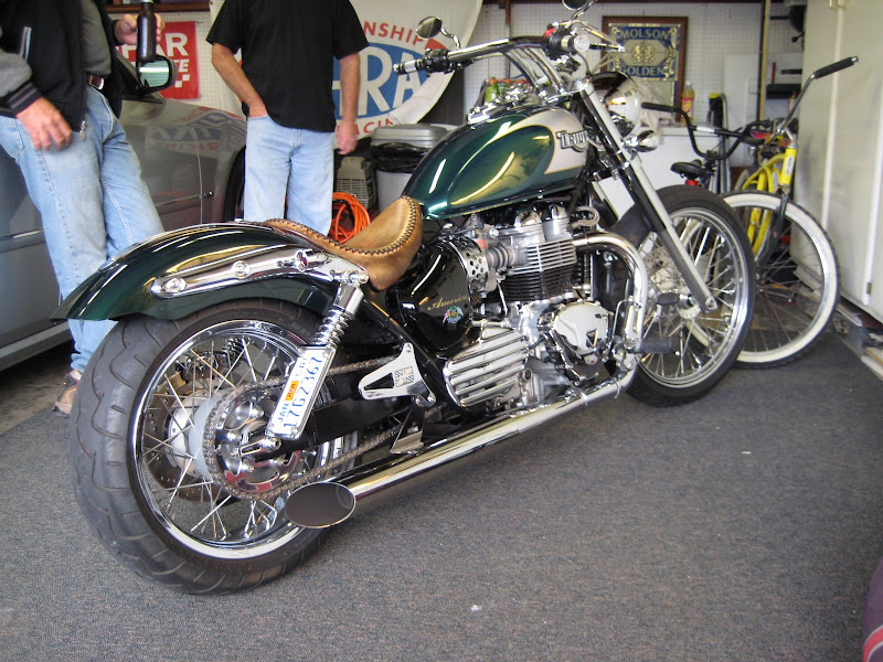

I did a bigger tire, not a bigger wheel. You want to go with bigger wheels, right Dave?
Re: Wide Tires
roadworthy #317589 03/01/2009 7:55 PM
Talk to Soul_Survivor. He has bigger wheels on his. Looks really sweet, too.
As I've said many many times around here...I NEVER get tired of lookin' at Doug's BA bobber!
(it's saaa-WHEAT!!!)

Davespain from NC..PM me. Its more involved than putting on a wide rear tire. Gotta do both front and rear, and adjust the suspension so that it all works together. get it right and its better than stock. Ride safe
Doug

I swear if I was in CA I would look ol Soul Survivor up and have him help me make my America look just like that. I have never seen a more beautiful bike nor one that I lust over as much.
