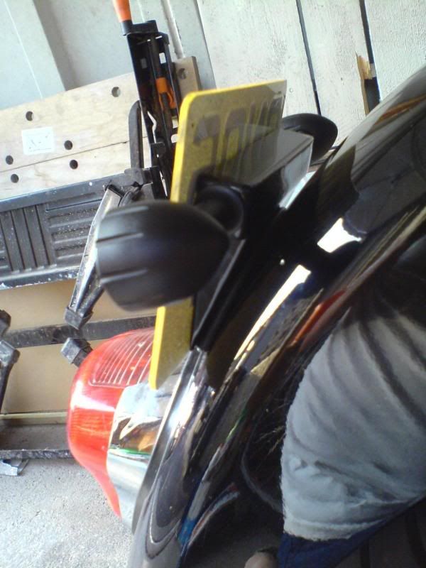

Here are 2 different aftermarket indiwinkers mounted on short stalks and stock plate mount.

Here are more pics as requested.
The left bike is Karens the right is mine. I kept her OEM lights mounted to shorter stems that mount to the plate bracket I made for hers. If you can visualize wings bent down or tabs so to speak. Turned out nice. I didnt take any pics when I made it so no instructions there.
A side view of both.
A better shot of Karens.

scuba_speed #312223 06/02/2009 3:13 PM
Posts: 311
Posts: 311
Heres a variation on this theme which I've just finished.
The cops over here are a bit hot on plates that lay as far down as the American ones so I decided to go half way, and I wanted to keep my flashers.
This is the bracket I made, had powder coated and fitted in place of original
These are with the plate back on, there not great pictures, in the garage and on my phone but you get the idea.
These pictures are rubbish, I'll take some better ones tommorrow.
Cheers
Chris
Re: HOW TO - make a laydown lic plate for under $10
oldgimmer #312224 06/02/2009 3:24 PM
Zmilin Offline OP
Chris....NICE WORK!
Looks great!
oldgimmer #312225 06/02/2009 9:27 PM
Nice job Chris!
Cheers
Chris
ssjones #312226 06/02/2009 9:57 PM
Really nice effort (and execution), Chris.
Edit: Okay, dumb question--how does the plate mount to the bracket?
