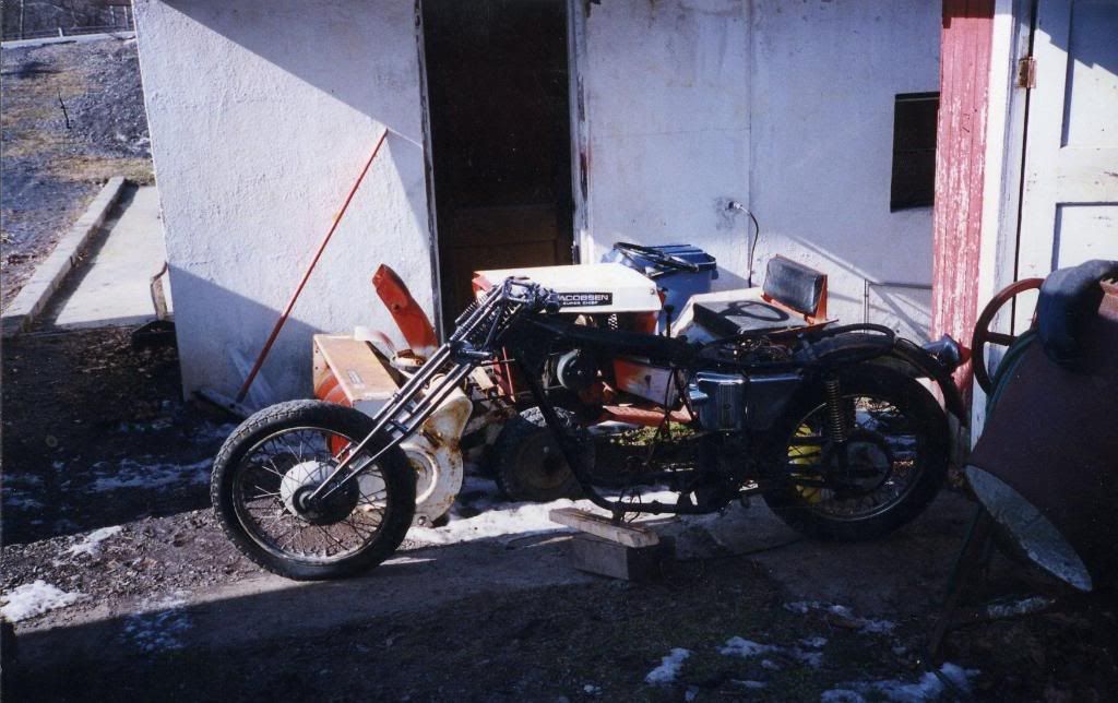

This girder on a bike I cut and raked has British patent numbers on it.
This is very early stages, it now has fat bob tanks on it and a skirted early sporty rear fender among many many other things. This is the last pix I took of it though, I do have a few earlier shots with the steering head cut off and nothing welded back on yet.
