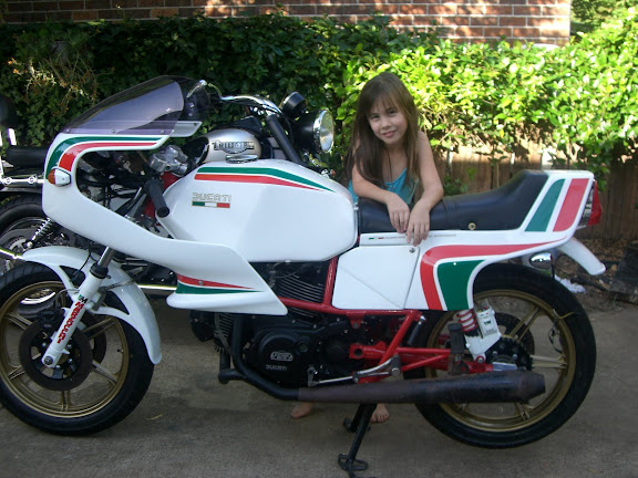

just about finished my restoration of a 1981 Ducati Pantah that was gifted to me. This is my interpretation of a classic Ducati motorcycle. My 6yo grand daughter wanted to be a bike model. I think she pulls it off well.
Rebuilt from the ground up and painted in the backyard. First paintjob I have took on. You may be familiar with the tail light! What do you think?

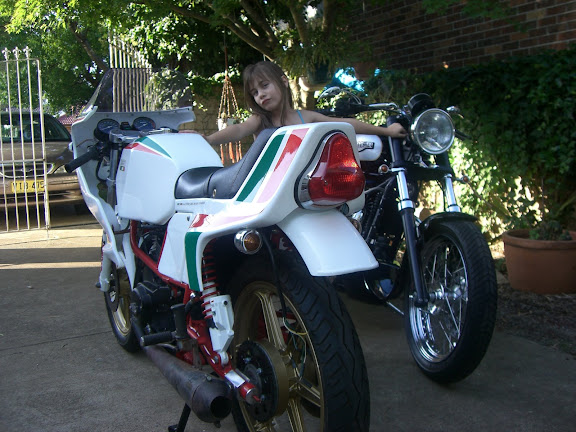

Beautiful paint, really accents the lines of the bike. Errr, yer tail light is upside down.
Re: my next other ride
Lazyrider #304543 12/15/2008 8:51 AM
He's in Australia, I think his daughter is upside down
Nice bike, great job
Lazyrider #304544 12/15/2008 4:37 PM
Could be OUR tail lights are upside down.

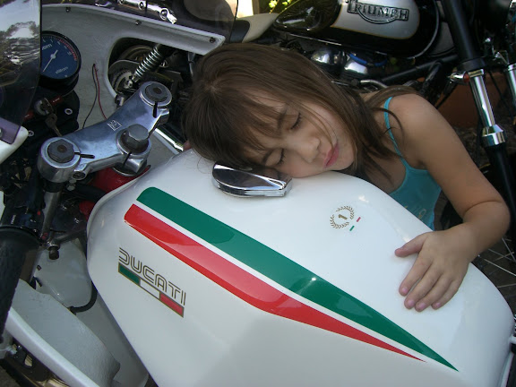

Way cool! Congratulations on a great job! I loved the pic of your daughter hugging the tank! Awesome!!!

I like the tail light, I think it fits very well.
