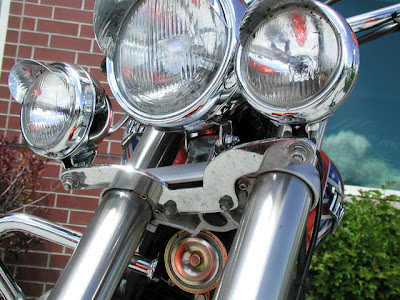

Here's the one I made out of flat steel to replace the triumph one (same lights).
There is at least one other like this, but it was machined out of aluminum and covers the bottom of the yoke better. It also is attached with the fork shroud bolts, not the lightbar bolts like mine.

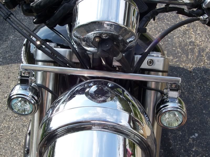

For a while I had this set up....

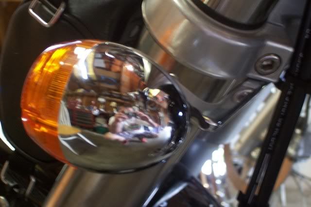

Standard JC Whitney fare with added turn signal hangers:
