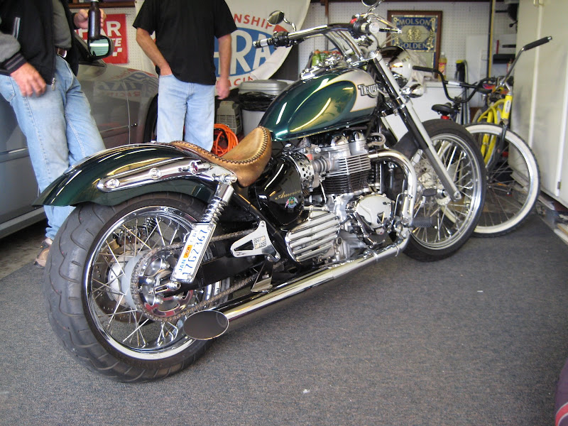

Does anyone running a 200 back tire have a pic that they can post?
Thanks ........
03 TBA 05 Iron Horse Texas Chopper
Re: Fat rear tire
Chopper #280175 07/24/2008 8:26 AM
Thanks ........
Not mine. SoulSurvivor's...

Re: Fat rear tire
FriarJohn #280177 07/24/2008 9:29 AM
Posts: 49
Posts: 49
That looks really good. I want one!

Re: Fat rear tire
biker #280178 07/24/2008 3:28 PM
Posts: 706
Posts: 706
good looking bike Biker
i must say that rear guard would have to be 1 of the best looking chopped guards i've seen
Re: Fat rear tire
srogerson1980 #280179 07/24/2008 5:02 PM
Posts: 529
Posts: 529
I will admit the fatter does look really cool, but how well does it handle compared to stock? That's the real question. Especially since I'm not one of those to trailer my bike to a riding destination.
Re: Fat rear tire
Dupre97 #280180 07/24/2008 5:14 PM
When I was down in California visiting (and took that picture) Doug said his bike handles awesome.

Any chance that someone with a stock rim running a 180 or 200 tire can post a pic? I went to get my stock size tires today and the local shop said that it was a 3 hour wait. I don't think so. So now I have the chance again to consider a 180 or 200. It will cost me a lot more but if it looks and fits good I'll go for it. Any input from someone that is running one on a stock rim would be helpfull.

Re: Fat rear tire
Chopper #280182 07/25/2008 8:40 PM
Joined: May 2005
Posts: 403
Joined: May 2005
Posts: 403
Alrighty then..I have been asked this a hundred times from many of our members...and I'll answer another 100 times if it will save someones life...
You should not mount a 200(or a 190) rear tire on the stock 3-1/2 rear wheel. Its dangerous and anyone who says that it can be done either has not done it, has 'seen' someone else do it, or has not crashed yet. That and it will tear up the tire and rear fender and the wiring that goes with it with stock shocks.
Play it safe to ride another day and do it right.
The difference between a 170 and 180 is not much and won't look that much different.
Its all about balance and our bikes are the best balanced cruisers out there.
Ride safe,
Doug
