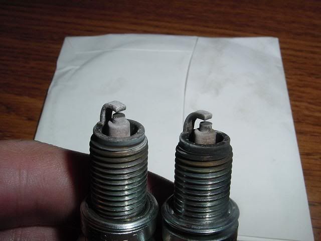

So far it's running great. The power band is much higher (obviously) and it accelerates faster. It's a bit lean so I need to increase the main jets (plugs are very white burnt). Decel popping is still there at 3 turns but after thinking about it doesn't turning the screws out richen the mixture by adding more fuel? Isn't the popping created by unburnt fuel because there's too much to burn in the chamber so it's getting burned in the pipes therefore you would need to decrease the fuel to eliminate the popping? I've turned the screws down to 2 turns to see what that does.

My money's on upping the pilots to 45s.

+1 agreed
Regarding turning your screws in, don't, it will only make the popping worse.

Fortunately I have some of those on hand so that's the first thing I'm going to try. I dropped it to 2 for a little bit but it was worse and took them back up to 3 turns and it's better so I'll leave it there for now. I've balanced my carbs but the right plug is always dirtier than the left (has been since new) so I may unbalance them slightly to favor a higher vacuum on the left. The current state of the plugs is black and sooty at the base of the plug but burnt white (I don't know what else to call it) at the electrode and the hook (everything higher than the outside threads).

Sooty at the base would normally indicate too rich. You might want to try going DOWN on the mains and upping the pilots to 45. You didn't mention if your airbox was removed. 150 seems quite high if not. Some decel popping is normal with less restrictive exhausts. You might try turning the screws out to 3.5 and see if it gets better, but if all decel popping goes away, you probably should turn them back in a bit.

I took the airbox off some time ago. My current setup in the order I have done them over the years is:
No AI
Epco pipes (130/45 2 turns out)
Freak kit with K&N filters (150/42 2.5 turns out)
904 BB
Each iteration was dialed in very nicely with tan coloration on the plugs and very smooth running. The soot at the base tells me that one end is rich and the popping makes me think it's the bottom (pilots). It's the white burn on the electrode end that has me bothered. I'd rather have it a little rich than lean.
Here's a pic of the plugs on their respective sides. They're looking better than they did earlier today but from previous experience I still think they look bad.
Re: Big Bore Success!! (so far)
EnglishYankee #278828 07/15/2008 6:03 AM
From the pictures it looks like you need bigger squirters all the way around, pilots and mains. That left plug is lean, way lean...the soot looks like a lengthy idle session with the enrichener engaged.
