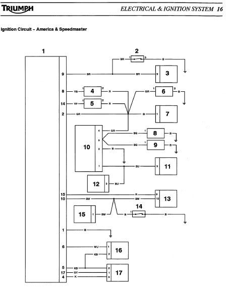

I have got a bit of a problem when starting my bike. Nothing at all happens with side stand down, in neutral etc. If I take the stand up, still in neutral, nothing. If I then pull in clutch lever, it will start. I can then let the clutch lever out and it will not cut out, but it will if I put the stand down, even though its still in neutral.(Checked the fuses, battery connections, neutral switch wire for grounding etc)
Been to the dealer who reckons its either the neutral or the side stand switches (among other things) - anyone else had this problem? And another thing - the neutral indication light is out as well.

Sounds like a bad neutral start switch. I would start there.

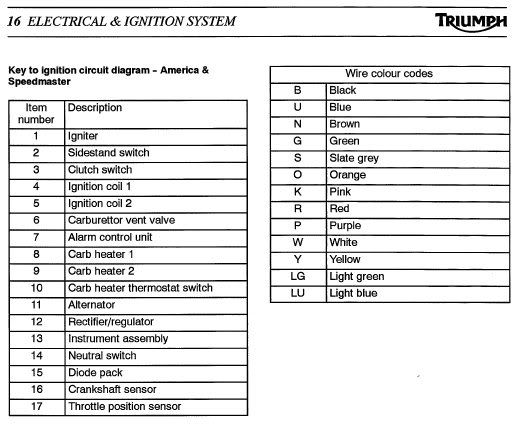

I would tend to agree with Rob. Neutral switch 14, Ground or diode pack 15 but Im not sure how that thing works.
