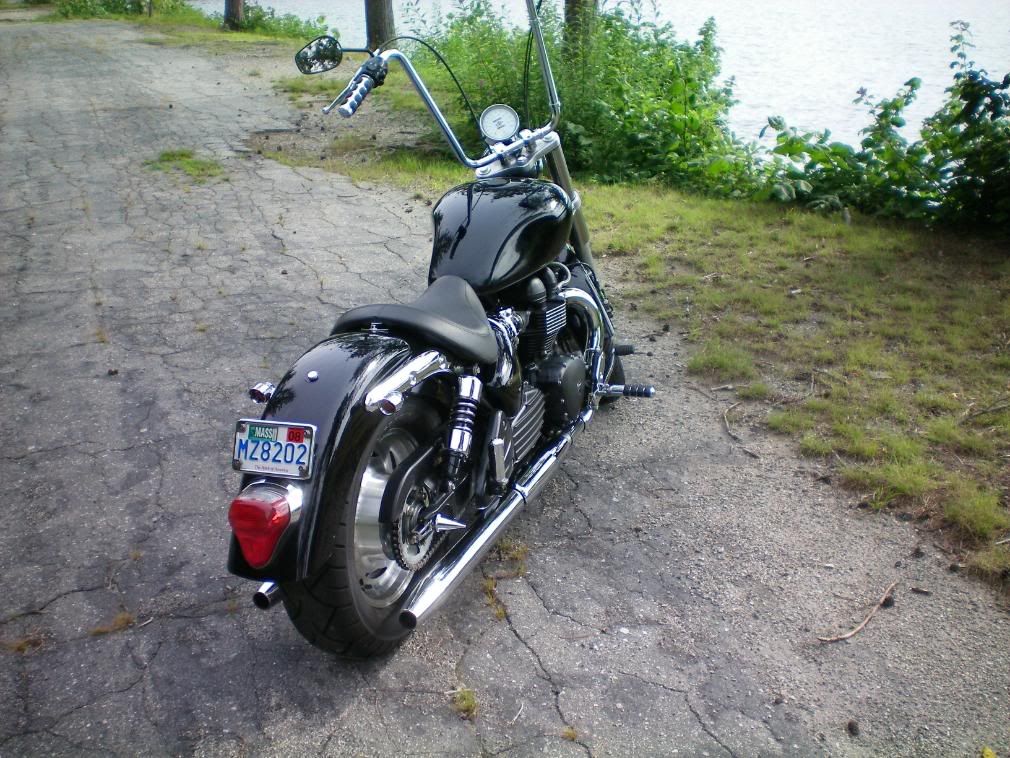

i been trying to find shocks 2" lower for ages and had no luck, only progressives i can find are 1 to 1.5 inch lower. anyone got insight?
how is the ride if you chop the springs
I have progressive 412s They're exactly 2" shorter then stock. I don't have the box that they came in but it's at my shop. I'm sure I could get the part # if necessary. I slammed my bike 2" front and rear and the only thing I've scraped was my kick stand a couple times while 2 up riding.
your a champion, thanks heaps
tank looks alot better too, did you mount the lights somewhere else?

Verceti #272251 08/11/2008 5:23 PM
Posts: 1,284
Posts: 1,284
I haven't mounted the lights yet. I 'm messing around with a square piece of aluminum. Thinking about drilling a 1" hole through the center,slicing just off center then pinning to bars via set screws. This would give me a small clean block to polish up right between the risers. Drill that puppy for four tiny electronics leds and I picture a real cool sleek set-up. Or,I just noticed a real cool bar mounted set in JP cycles to do exactly what I need.
