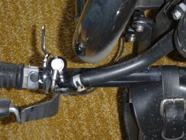

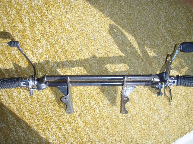

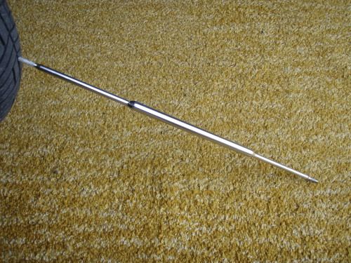

The original thread on this subject isn't much good as photopost is still down so here's a few pics for you to get an idea of what I did...
Cut out the middle bracket and replace with pipe, I added 20mm for clearance of gear change rod.
I had a block of 4x2 and tied it in position with the new control bar and made cardboard brackets. All welded up.
Lengthened the gear rod by cutting rod and sliding the ends into a piece of stainless pipe, this was the most expensive part of the whole operation, tube and SS welding.
My new riding position.
Used the original brake line, bent to fit and not that pretty, but it works...

wildmike, I have to say excellent job. I never thought of doing it that way. I was thinking of hacking off the mounting brackets from the bars, rotating the bars 180 degrees so they wrapped around the front of the pipes. I think I like your idea better though.
Definitely going to get on this mod very soon. Thanks again.

I had thought about making longer brackets and using the original control bar, so that the pedals would come around the pipes. but from your photo this wont work
