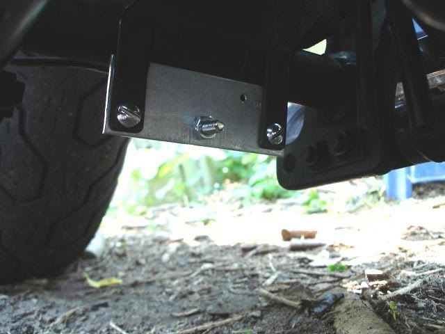

Since I got rid of my airbox ive needed a place to stash a couple tools. I figured I'd take some pics through the process to help anyone interested. These 2 tabs under the bike is the spot where I wanted to work with...

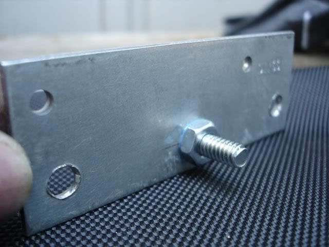

Heres all the parts needed...(4" piece of steel drilled with 2 holes to mount and a center hole)
Assemble like this..(1/4" machine screw and nut i forget how long)
Then mount..(The holes on the tabs dont have to be drilled 1/4" screws slide right in. I used lock nuts on the back)

Then mount using the 2" conduit clamp, washer and thumb screw.
You cant see this thing at all from the sides or anything, i was gonna take a pic but there was nothing to take a pic of. Im gonna paint it black eventually after the "trial stage" I havent stuck anything in there yet, I plan on riding around with it first and see if it melts from the heat or falls off somehow. I really cant see how it would fall out, the clamp holds it tight against the back bracket and theres no side to side movement, and I added some loctite in the thumscew.

The tubes length fits exactly between the 2 bottom frame rails so you cant remove anything until you remove the tube. Which is good cause you dont have to worry about the cap coming off while riding.
I also thought about attaching the conduit bracket directly to the tube with a couple rivets so when youre taking your tools down its just a thumbscrew and a washer to worry about losing. So the tool tube and bracket are one piece.
