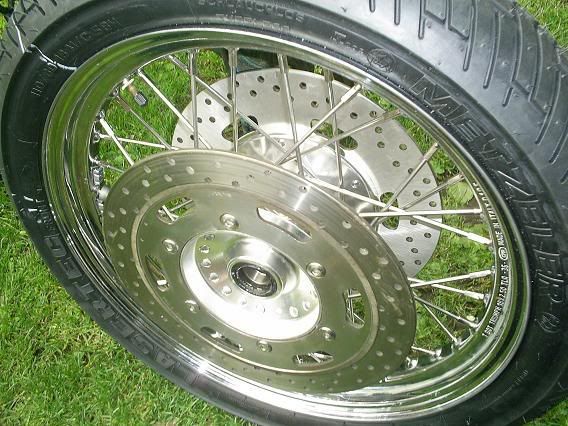

Has anyone put one on a speedmaster? Are there any major mods needed?
Ideally I want to switch to a wire front but don't want to lose the brakes. Is it possible to have the wheel re-laced to a larger size, say 19 or 21?
or is there someone out there selling aftermarket wheels that I'm looking for?

MY understanding is that the TBS front hub will replace the BA or Speedmaster front.
And yes, you can lace any size rim to the hub. You may have clearance problems if you go too big though.

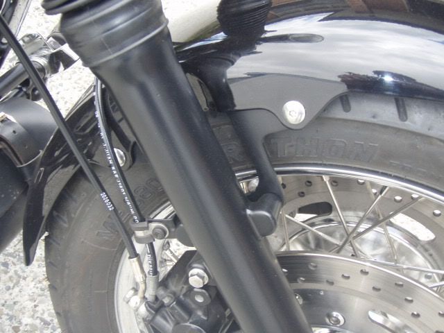

On my speedie I left my TBS front wheel stock and mounted a 140/80x17" tire... Fits straight on with old spacer and speedo drive, just had to cut out the indents on the fork brace/guard mount to get that fat sucker in there... I wanted the fat front look...

cool mike, have any pics?

Stock TBS front 17"x3 1/2" rim with a 140x80 tire...
And fork brace/guard mount cutout, bolt holes haven't been moved...
