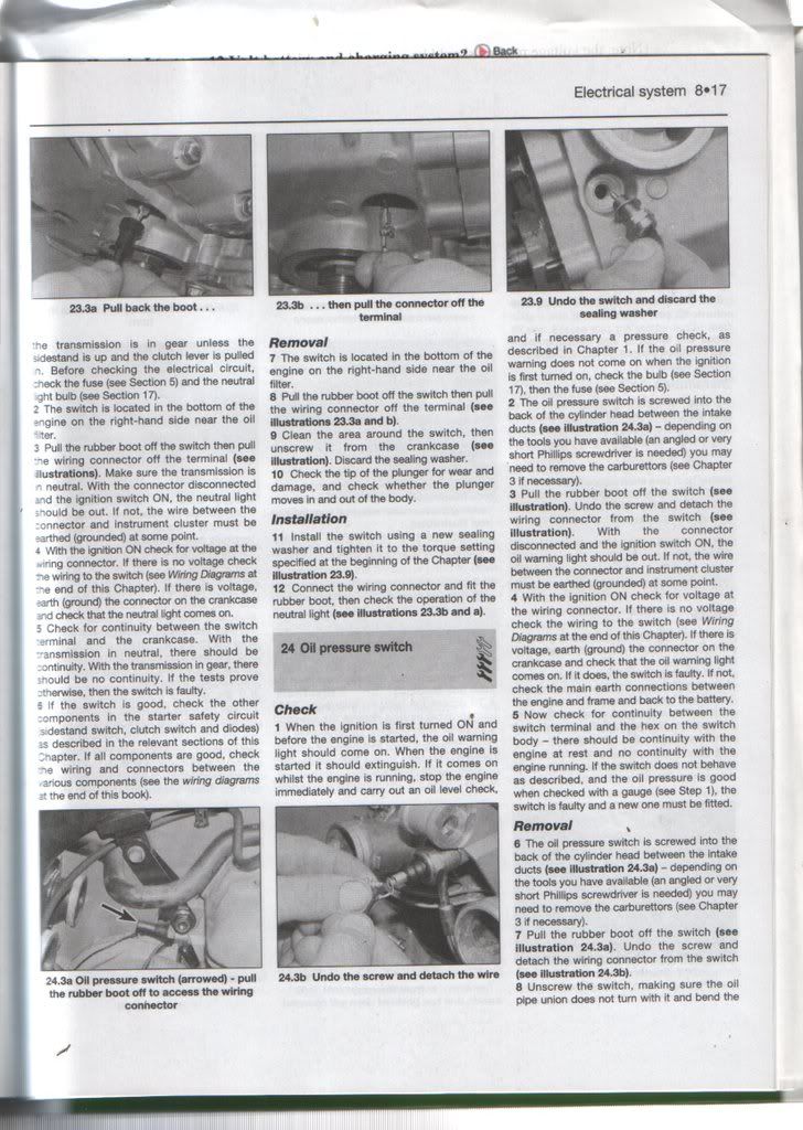

Just checked this out, it is in the Haynes manual Part 8.16 Electrical System, part 23 Neutral switch. Pretty good pics as well..

Ray,
Did they talk about the release for the spade connector?

I looked in the obvious places in the shop manual and the do not cover it that I could find, just as verification. I look in the electrical and tranny sections and didn't see anything,well I saw stuff but nothing about the neutral switch!

It's not in the Triumph book I've got either.

Ray,
Gary
Hope this helps Gary

Ray,
The manual you have nicely shown in the post doesn't talk about the connector release like on my bike. maybe I have an updated one or (?). I wasn't able to pull the boot down like it shows there and I tried to do that even after the wire was disconnected from the switch.
Thanks for the information.
