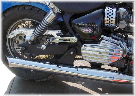

Take credit when credit is due! I don't often have good ideas but once in a while...once in every great while. I found an application for a RIVCO product that will serve the America and Speedy riders. I presented the idea to RIVCO and guess what? It worked! They liked it and put it in their catalog!
I tested it out on my bike and it is an incredible option and is fairly inexpensive and most of all it works! Gives at least 175 degrees of options, can also be used for a passenger peg option.
Another option for rider comfort.

Very Handsome! Are they only attached at the top ed? Seems like that would be bendy.

Sorry for the delay lads. Only pegs can be attached as a board or flat item would spin under weight.
They are only attached at the top, but they are rated for weight bearing, a beefy peice of metal. I'll give a test to standing on. The engeneer at RIVCO thought they would do just fine and they were tested at weight bearing but I can not recall the exact number.
The clamps will hold a freight train, they are really mean. Has a huge bolt that holds it to the clamp and titanium pins to lock it in place.
I warn anyone using any such device to make sure you mount the pegs so they fold backwards and up at at 45 degree. That way when you plant your foot on the ground with the pegs down it will not snap your lower leg but fold up and back. Also keep the peg from bending if you lay it down or tip over!
eddy
PS, I just tested the weight bearing of the peg/mount. I am only 185 pounds, but full weight on the pegs and bouncing, the bracket flexed VERY little. I certainly would not be afraid of standing up on them myself going down the road.

It's a clamp that is circumfrential and has a four point mount and it is BEEFY, actually it just fits in the allocated space. Snugs up to the side cover on it's back corner side but Ihave had not trouble with it.
I'll take some more pitures today.
eddy
Didn't get to the pictures today sorry. Did hear from RIVCO on weight capcity. They said rated at up to 248 lbs for standing on it.

Sorry for the delay on the picture. As you can see it is beefy. A titanium pin keeps the arm from rotating once the selected position is chosen. As for weight bearing, since the main purpose is for driver comfort when traveling weight bearing isn't an issue. It is not reccommended for passenger use as it is designed for use as a highway peg with weight limitations of 248 lbs.

How does the mounting point physically mount to the frame? Two halves pinched?

Yes two C type clamps with four bolts as pictured above goes around the frame tube. Worth repeating, these are highway peg mounts made for mounting on engine guards and not designed for the purpose weight bearing as in a Passenger but a passive weight just as in forward highway bar location.

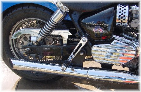

Is there clearance for the right side foot rest arm to rotate a bit more forward? What I mean is, will the footrest arm clear the "George Foreman Grill" front sprocket cover?
I'm about ready to pull the trigger on these but would really like to know this before dropping coin....

In this picture you can see how forward I could go on mine before the bolt head would contact the "grill". It may be possible to use a rounded head bolt and that would allow some clearance to swing but it is still a pretty close fit. The arm itself with no peg on would swing around without contact but with the peg bolt is where the problem occurs. I am not sure but one of the new Non Foreman Grill types may not have an issue.
If your wondering about foot/leg position let me know what your looking for and I'll take some pictures with legs attached!

Good enough Ed. I'll get it sorted if need be. I just ordered a set.

FYI I sat on Dave's (leonics) bike yesterday with those pegs. VERY comfy, even for my fairly long legs. I think you'll like em. If you need it farther forward, it's a good excuse to get a T100 sprocket cover!

Good to hear, and you're right. A smaller T100 / Thruxton style cover would work perfect.
