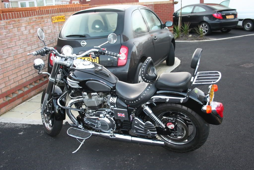

Just to add a query while we're on the topic of the bars...
I'm also looking into buying some of the crash bars (the triangular ones) for my '07 America.
Simple reason being, i want to protect the bike for when i (some would say inevitably) drop it. Specifically i want to protect the costly guts of the thing to save me forking out repair costs in the future.
So the question is, how much protection do you think the triangular bars offer in the case of a drop?
Thanks for your time.
Anthony
Re: 2007 America Engine Guards
JesterMinute #253517 04/09/2008 4:11 AM
The triangular bars do not give much protection, if you drop the bike, They will of course protect the engine, but the floorboards etc will take most of the hit.

JesterMinute #253519 04/09/2008 4:43 AM
Might give you an idea Anthony of what they look like on and what they would save
