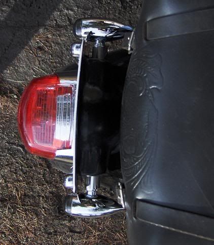

I did these on mine, front are amber and rear are red but both look smoked when not in use.
And these on Wendys bike. I don't have any good shots of what I was going to show you on my photobucket acct. I used $8 old school bullets. These are at J&P but they are $12 there.

OK uploaded the other shots of Wendys bike.
These were very easy to do, I took the bulbs out of the origonal lights and put them right in these.

where did you pick up the one's you're showing on your bike? Were you able to use the stock stalks? How hard was the installation? I like the way these look smoked when not in use.

The signals are Kurkyan or how ever it's spelled I got from my friends bike shop. They are available anywhere. Mine are LED and require a new flasher or a load resistor to work but they make the same lights with a bulb in them instead that doesn't require anything to use. The front all I did was drill the stock mounts and mount to the top of the mount instead of under. They have a threaded hollow bolt that the wire comes out of. On the back I used a stainless spacer from the hardware store and a longer threaded stud. On both I cut the plug off my old indiwinkers and soldered them on the new lights so I can unplug them if I needed to.
