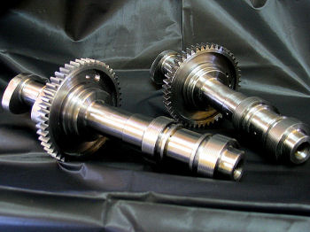

OK took some photo's can anyone identify these.

Might help is you had a profile shot of a lobe like so...

Closeup of lobes

look like a 270 cam to me, here's a 865/360 cam

You can tell the difference, but is mine a 790 or an 865 (270)

Its a SWAG, but looks like the 865. 865 cams have 0 overlap which would make them "pointy". Is there a part number on them? I have a shop manual.
The stock photo of Thunderbike cams from Brents site look like this

Hard to tell in the pictures but looks to me like it's a 270 as opposed to a 360 degree cam set by looking at the lobes. Can't tell if they are 790 or 865 for sure. At least I can't from the pictures.

From what I can see surely if the lobes from a single cam are pointing in opposite directions [180 degrees] this makes these from a 360 motor...

A little bit deceiving is that picture looking at the bottom cam the lobes to the right are pointing at 4pm while the others are pointing at 11am, if that helps..

I haven't seen the 865 cams, but I would think the exhaust lobes would be a lot closet to being pointy looking than the 790 because of the relatively short duration. If you had one of each to look at, you should be able to easily see the difference.
Thats why I said 270, those lobes don't look straight across to me in the pictures.
