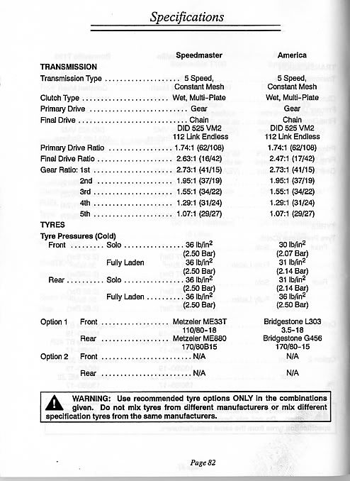

Hereis a scan out of my 2004 owners handbook.
TriumphTalk.com Your Online Community

Who's confused then cos this came out of the official tech manual issue 4 10.2004
Mind you, it does make sense to increase the rear tyre pressure if you have a load doesn't it. Doesn't it?
EUREKA......The riddle is solved
Thankyou Staffo for showing this page of your manual.
If you look at the pressure specs for the speedy, they are shown correctly in metric,ie 2.5bar, front and rear,laden or unladen, but they didnt convert to psi correctly,as will be obvious if you look carefully at the america versus speedy pressures.
So all this confusion is down to poor editing of those paticular editions of the manual, and obviously picked up and corrected by 2007.
So all you speedy owners, forget psi and blow your tyres up to 2.5 bar(36psi)
