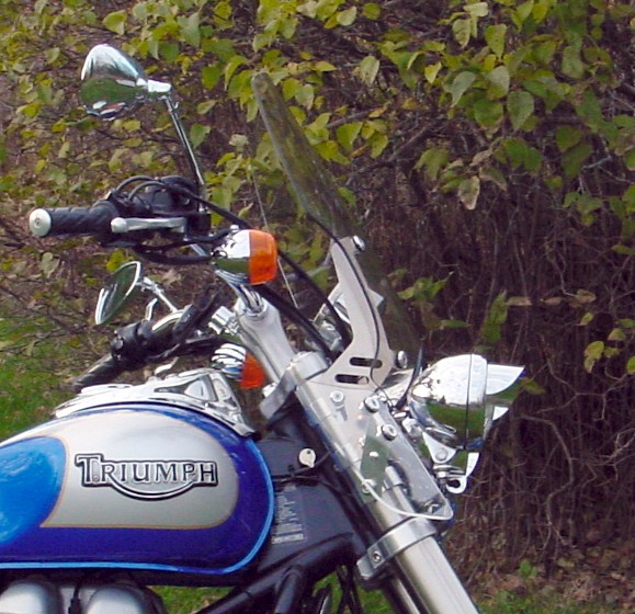

I made a pair of custom windshield lowers. I used Memphis Shades Lowers Mounting Hardware, with homemade plexiglass (.220 inch thick) plates (10 inches wide and 13 inches tall). I bought the plexiglass plates at Lowes. I cut the plates to seal off the area underneath the headlight and go up to the Memphis Shades Alleycat Windshield. Results are absolutely NO BUFFETING AND NO NOISE AT ALL; just a nice big QUIET air pocket (no airflow over the fuel tank). I originally made the length about 3 inches longer(downwards) but it still did not help protect my knees from the wind, so I cut it back to the final 13 inches height/tallness. To cut the plexiglass plate, I used a 18 tooth blade in a variable speed hand-held jigsaw to cut the plexiglass plates. I finished by adding a trim for the top edge made of a split rubber hose.
PS: After making a cardboard template, I used masking tape (top and bottom side) on each of the two plexiglass plates to prevent splintering and for marking the cutting line. Also, there is a notched-out area in front of my two driving lights, below the lower fork triple-tree.
PPS: It was amazing how much quieter my helment is now, and it is absolutely silent up to above 85mph, which is fast enough for me.

hey, very cool tom. it goes just a bit below the lower triple tree between the forks right? and a couple of inches further down outside the forks?

Yes, that's right.

Tom, didn't you have to modify the Memphis hardware to mount it above the triple tree? I got the Memphis lowers, and at the "smallest" notch they still way too big to fit anything but the fork shrouds. And mounted that low they divert so much upward that I may as well not have the windscreen.

Tom: I'm not sure whether it's the screens that are different or the way we've got them mounted but my lowers are way further back than yours. I don't think I could make them match up as well as you've done.

He is using the upper tube mounts which are smaller. Not listed any where as it is a non traditional location. Tom and a couple others had me dig and I found the size that will fit the upper tubes and now list them on my new site for that application.
And Bill, the reason they are further back in your case is that the Lower tube mounts have a longer mounting bracket than the ones for the upper tube mounts. I never noticed till just now. Part in parcel the trouble we have when companies don't make stuff for our bikes.
I bought the upper tube mounts to try out on my own bike before I started selling them in that application to make sure they would fit. I never used the lower tube and never saw pictures side by side. All I have heard was the lower tubes made a difference in the buffeting reduction.
On mine, I have the lightbar so I have to have them angled back to avoid contact with the screen and light bar. They STILL made such a difference that I kept them on. Originally I was not going to use them because I was not a fan of the look but I was won over by performance.
