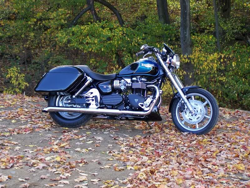

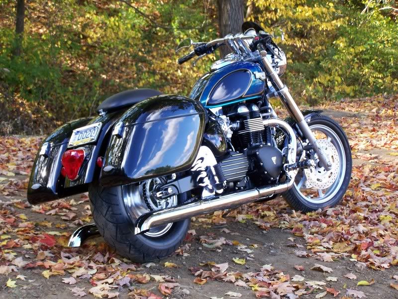

To take them off and on 4 bolt and a plug for turn signal.And think a lap top will fit,they are very water tight to.heres mine [image][/image] [image][/image]

those look great.

i like the pipes, too.

Thanks Cat I get a lot of compliments on the pipes.This time of year they make good leaf blowers.

Well they started out SS long cannon.Then I cut 12" off and used a 18" turn out 3" ID and slip them on.Then I can split them and take the baffles out when need.

Not trying to threadjack here, but... Hey midlife, what did you do or use to get the liscense plate flush to the fender itself? I like that look, hard bags or not.

I removed stock plate holder and use the rubber gasket as templet. Had a piece of 3/16 ss plate cut and drilled and mounted it useing the rubber gasket as a spacer.

those pipes are boss, too.
who makes them?
cAT
Re: Hardbags
cat #209562 01/15/2008 1:01 PM
Yep, he made the pipes,exhaust extensions from a tractor trailer.I liked them too and asked when he first did it.

You know Dog33, when you say it like that its kind of funny but true. And thanks cat, I did it because I wanted turn down could not find any so I made them.

Yes, I drilled the hole for the wire just under the rubber gasket by the front bracket.Ran the wires behind the fender strut and picked up the turn signal wires under the seat.I left the orignal wires in place.One more thing,put a two pin plug on the out side of the bag to make them easier to remove. Put so sealent around the wires their they come out of the bag and your done.

I seldom tire of seeing what people do!! Your's is exceptional. I like it.
Re: Hardbags
freedom #209568 01/19/2008 10:36 AM
Posts: 2,726
Posts: 2,726
It's definitely one of the most personalized Speedy's I've seen. All your effort shows.
Re: Hardbags
RamSound #209569 01/19/2008 10:52 AM
Posts: 585
Posts: 585
A very Beautiful Bike indeed!

MIDLIFESPEED. How in the heck did you get that first one to line up? I see yours skirt just barely beneath your rear fender,did you eyeball it or by some other means. SPEED.

I made a cardboard templet to lay out the holes.Sorry, But threw it away.
