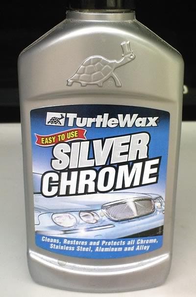

I had a man-made fibre m/c jacket full onto my hot pipes one day. Made a terrible mess. I got the pipes really hot when i got home and scrapped most of the goo of with a wooden popsickle stick, then rubbed for ever with Tutle Wax Chrome Cleaner. Came off a treat.
But some of the other suggestions here i think would save a lot of time, effort and elbow grease.

I don’t know if you get this stuff over your side but as an end product when you have most of it off would return the pipes to new.
