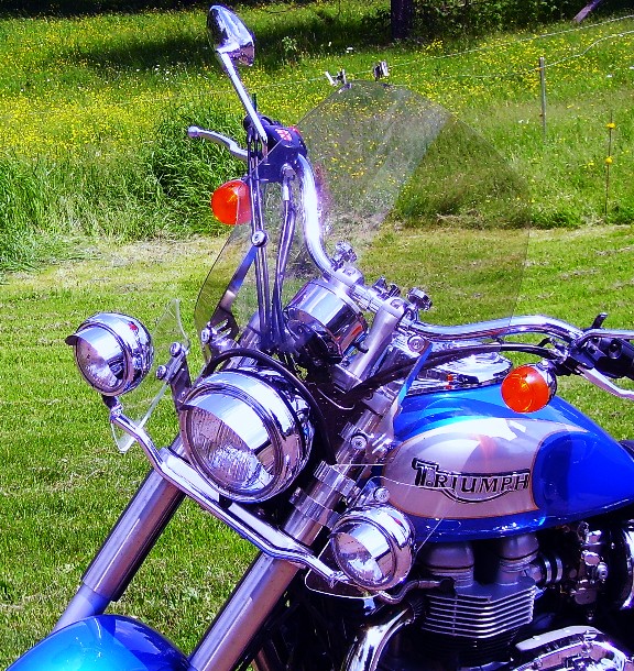

Posts: 1,934
Posts: 1,934
Tom,
They rest solid and don't move anything. I have a set on the upper fork shrouds (requires different mounts)and they work nice in conjuction with the driving lights which hide them.

Fasteddy #188647 08/04/2007 7:16 PM
Posts: 691
Posts: 691
Eddy,
I like that. That is where I thought that they should be mounted (on the upper fork shrouds). Also, do you have yours rotated to be slightly in front of the windshield, or could I rotate the brackets to do that? If so, that might keep the wind/turbulence from coming from between the forks and up over the tank.
Is that a MS Alley Cat windshield?

Posts: 1,934
Posts: 1,934
I have mine rotated backwards to accomdate the light bar, loks cool that way and it did make a difference in airflow. I didn't want lowers but they made enough of a difference that I kept them on.
I have the mounts for the uppers. But I do think that the lower mounts do make a difference too.
I have not tried this option yet but one of the members mounted teh lowers via one of the lower windshield mounts by removing a spacer.
