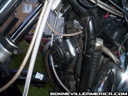

Here's the compressor. Still need to hook up an "intake" to under the tank I think. I figure it might get wet where it is...
And this is the horn. Snipped off half the bracket and drilled a small hole. I think that may crack, another reason to relocate it...

Glad to hear you got it working Ben. Nice relocation job too.
