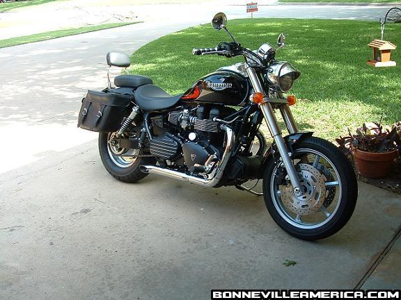

I am looking @ putting some short pipes on speedy but would fancy looking at a picture of a speedy with them on does anyone have 1?

Well these pipes are about as short as I've seen on one of our bikes.
