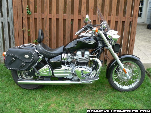

Today I installed my new SS Long cannons on my 2006 TBA, I also have a K&N drop in filter and the Snorkel is removed, The Air Injection is also removed. I did not do any rejetting to the carbs. I took the bike out for a couple of rides and it runs flawlessly. There was no backfiring and there didn't seem to be any flat spots when hitting the throttle, the bike sounds great. My question is this, Is it going to hurt anything if I don't rejet the carbs?

you might. You are probably running lean right now.Do the cannons have baffles in them?

Posts: 36
presto Offline OP
Posts: 36
Yes, the baffles are in and have not been modified

presto #153461 04/20/2007 8:01 PM
Posts: 23,244
Posts: 23,244
You are probably OK then but I would still dyno to be sure. They are lean from the factory so you may want to dyno it and adjust accordingly. Chances are you are not so lean you will hurt anything. Alot depends on how restrictive or nonrestrictive those pipes are. I never messed with those so I can't be sure. Maybe someone with experience with that particular exhaust can give you a better idea.
Dinquas calculator says 131.5 main so if you are running stock jets you are lean. I guessed your altitude and left everything stock except you said snorkle removed and K&N filter.

The_Dog33 #153462 04/20/2007 9:03 PM
Posts: 3,606
Posts: 3,606
SS usually comes with 135's Im running SS short slashs, no snork, Uni (almost identicle to the kn) TBS needles and 45 pilots, don't know how many turns out (I tune by ear and "best idle method" so didn't count turns...vacume ports are cross conected and I'm prob a tad rich...but I still have a healthy gurgle on decel so I'm good (seat of pants dynoed)she pulls strong in all throtle positions with no lag or flat spot's... if they are still running 120's for main's in 06 your most likely WAY to lean on that setup dinq's jet calculator is about dam near spot on...

presto #153463 04/23/2007 9:52 PM
Posts: 4,932
Posts: 4,932
i ran 132's when I had that set up...900+ ft above sea level.

Posts: 36
presto Offline OP
Posts: 36
Thanks for your replys, I had the carbs rejetted and the bike is running great now, no more popping on decel.
