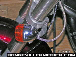

Nope it's a bracket. I'll see if I have a better shot... Originally I just relocated them, then I got another set of rear signals for them so I COULD pass the wires thru a hollow bolt, then I put on the LEDs last year.
This is the bracket from the underside (also showing Brent's gauge). There are tabs that bend up from behind the fork tubes.

Is that line that looks like it's gonna get pinched the oil line too?I do see how there is enough length that the twist from turning the bars shouldn't be a problem. Would still bother me though.
Re: relocating the front turn signals
The_Dog33 #150074 04/10/2007 8:58 PM
Hard to tell from that pic how far back that line is, but its a ways back, not in danger of getting pinched at all. It's zip tied to the spine under the tank.

In the pic it looks in peril but its hard to get a feel for depth in a photo.

Ian, here is a side view of the same oil line. You can see it dissapear up under the tank.
