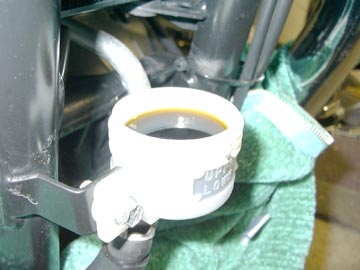

Take the outer, smaller of the two, and put it back into the caliper assy. Line it up so the metal side is in the caliper and gently push down with both thumbs. The pistons will go down but with a lot of resistance. Push slow and easy so you don't force the brake fluid out of the front reservoir. That's why we made the level 1/2 full in the beginning. If there is too much fluid or you push to fast, it may overflow. Clean it up right away if it does spill.

Check the fluid level of the front brake fluid reservoir and replace the cap, being very careful not to get anything into the cap or reservoir itself. If it spills, clean it up right away.
