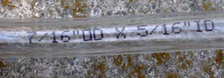

I bought an 8 foot piece of 5/16" ID vinyl hose for a gas line extender. I also used a 5/16" stainless steel barrel connector. You can get a cheap nylon one, I just happen to use this size in my brewery and have a lot of little SS connectors around. You then connect the vinyl hose to the carb intake gas hose using the 5/16" barrel as pictured in the right photo. You don't need to worry about clamping the hoses, they are pretty snug by themselves. But safety may dictate otherwise, you be your own judge of this.
